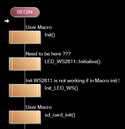

Unfortunately, for some reason the LED component cannot be initialised in the macro but only in the main.
However, the comands for the colour and brightness can be easily used in macros
Testet 100times....

Perhaps there needs to be a delay or some other code happening before the Initialise() macro is called.
What is within your Init() macro? And does it matter if the Initialise() is at the start or end of that macro?

I have tested with delay before and after many times.
But it only helped to put the component init into the main.
Even if I switch from main to macro without or with a delay, it only works if the component init, is in the main part.
It is not a big problem, the LED works perfectly after that.

Does it fail to compile if in the Macro or does it just not work (initialise)?
Using a PIC it compiles in either.

It's compile always, just the led is not working.
What also happened a few times was that the LED lit up at full power in white.
At the moment it seems to be working and I realise when it's not.
I'm not sure if it has to do with the ESP-IDF 5.12

Also, what if the Initialise() is in Main but comes before the Init() macro? Does it work ok then?
Re: ESP32 and WS2811: init in macro not working
Posted: Fri Jan 26, 2024 10:21 am
by stefan.erni
Yes !
