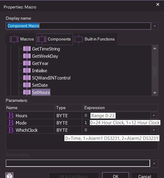

when I try to set the 24 hour value (rtc module default format) to 12 hour format.
specifically to change from 0:00 format to (12 hour format), which should be (12:00am), as shown below.
00:00 (24 hours format) = 12:00 am (12 hours format)
problema rtc.jpg (48.98 KiB) Viewed 3255 times

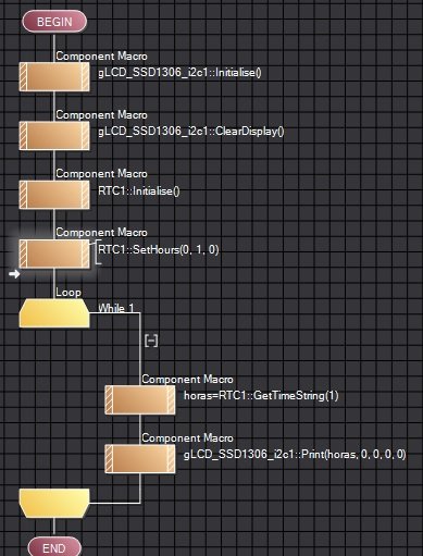

Using the following logic schematic loaded into the microcontroller as shown below.
diagrama problema rtc.jpg (49.97 KiB) Viewed 3255 times

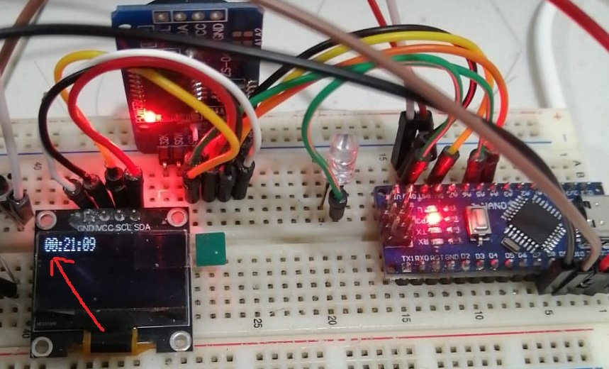

After loading it into the microcontroller, the logic that follows is
wrong --> 0:00 (24 hours format) = 0:00 am (12 hours format)
correct --> 00:00 (24 hours format) = 12:00 am (12 hours format)
hora no cambia.jpg (91.77 KiB) Viewed 3255 times
