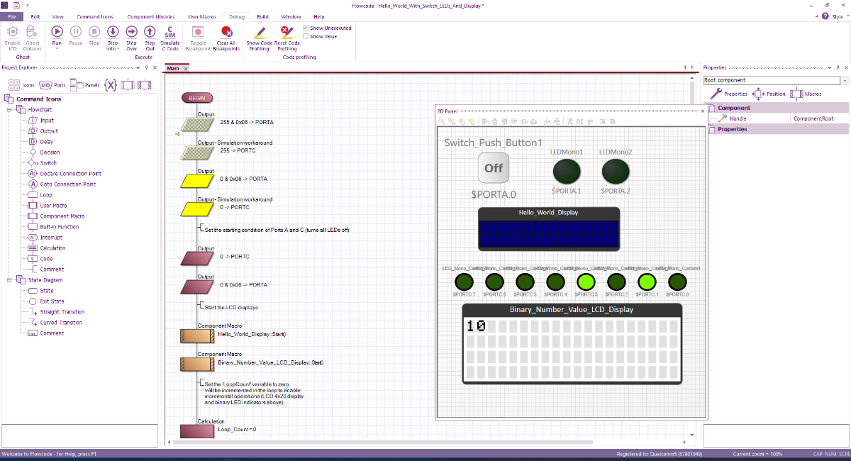

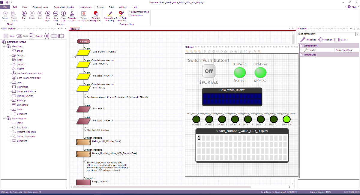

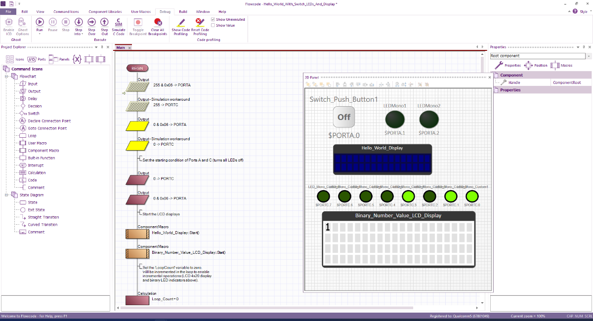

As a matter of course (emphasising good programming practice to students), I expressly initialise all LED-driving ports to zero, which originally highlighted this issue. However, I found a 'fudge' that appears to largely resolve dashboard persistence in the binary-representative display.
I provide three screenshots which include the start of the program...
1st simulation run with port initialisation icons enabled and fudge disabled. Allowed to loop-count to 10.
2nd - Simulation stopped, then restarted, and stopped at loop-count of 1, showing LED persistence from previous run.
3rd - Simulation re-run with fudge icons enabled.
Certainly something going on between PC speed/run-time timings and the dashboard, where the dashboard isn't always getting initialised before the debug simulation starts to run. This is obviated further by slowing the simulation down.
Thanks and best regards,
Brendan
Dashboard LEDs not initialising on re-run
Fudge applied, but also requires slow simulation for reliability

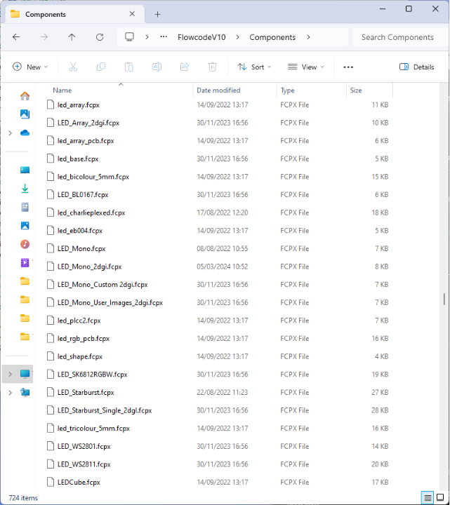

I have made a minor change to the LED Mono component.
Can you try it and if you are happy with it, I will roll it out on all the 2D LEDs
To try the updated component.
C:\ProgramData\MatrixTSL\FlowcodeV10\Components
Place the attached component.

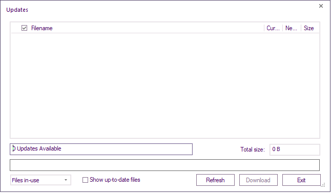

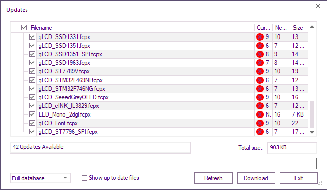

Can you select Help > Library Updates.. and take a screenshot and post the Updates windows, please.
Re: 2D Dashboard running simulation
Posted: Tue Mar 05, 2024 2:39 pm
by Qualcomm5
Hi Martin.
I provide the requested screenshots...
"Files In Use" reflects no updates, although "Full Database" does, and also double-checked the correct location of the replaced file (reflected by file date). Just to confirm, I have closed and re-opened FC a few times since replacing the file.
Hopefully this may be of some help.
Brendan
Replaced LED_Mono_2dgi.fcpx.png (155.56 KiB) Viewed 10543 times
