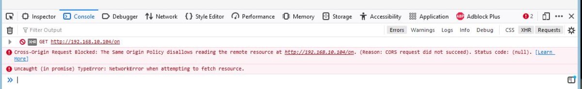

The issue in using the Example in FF v115 relates to CORS, but although going through the help files I've not yet found out why (probably just too dumb).

Exactly that. On my W8.1 FF throws a CORS wobbly but Edge is fine.

I tried disabling all extensions, didn't work, then compared my 115 settings to 123 and all my FF instances are set the same.

Firefox 115 on a W8.1 machine doesn't work due to CORS restrictions. Microsoft Edge and Google Chrome do work.
