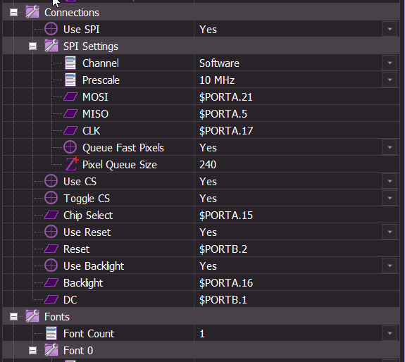

So i connented the display and it's compiling only if I use the SPI in software mode.
The display works fine in software mode.
Maybe you can take a look at why it doesn't work with the hardware SPI

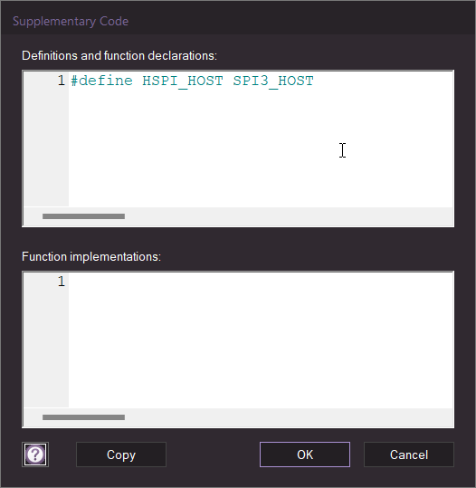

Hello Stefan,
Could simply be your IDF version. You're using 4.4.6 and I'm on 5.1.
You could try adding this line to the defines section of the supplementary code in the project options.
#define HSPI_HOST SPI3_HOST
but there may be other problems too.
There is also a way to upgrade your IDF version to 5.1 without having to reinstall, it works ok for me but others have had mixed results.
See here for details.
viewtopic.php?p=9222#p9222

I did both.
I get my notebook with ESP-IDS 5.1 and it's not compiling but in softwaremode it's ok
and i add the code and it did not compile

This is the error you're getting.
C:\ProgramData\MatrixTSL\FlowcodeV10\CAL\ESP\ESP_CAL_SPI.c:156:52: error: 'HSPI_HOST' undeclared (first use in this function); did you mean 'SPI3_HOST'?
Did you add the code snippet to the top window of the Supplementary Code? Could you please attach your latest .fcfx project file and .c file.

SPI hardware is not working.
I have tried with other components and with the SPI component and add #define ....
Just in software mode it is possible to compile.
