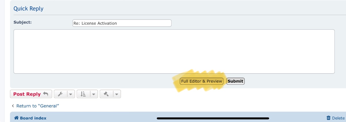

by kersing
Full editor and preview refers to the marked button in the picture below.
Once you select it you can use “Attachments” below the text box to add the requested files.
