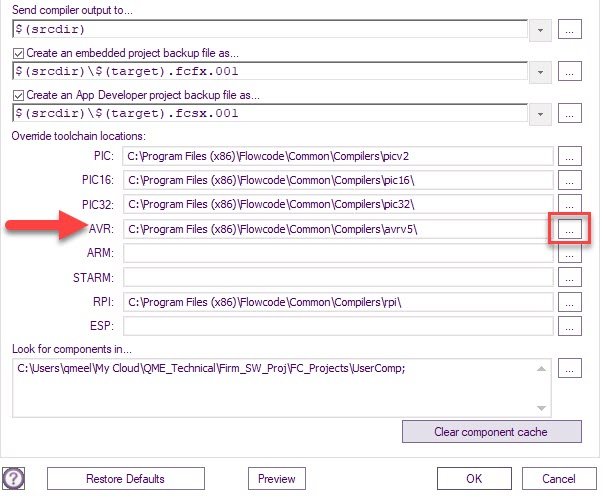

If you select View ribbon, Global settings.
Look at the Locations Tab
What path have you got for AVR?

Re: Avr Compiler Toolchain problem
Posted: Fri Feb 26, 2021 3:22 pm
by p.erasmus
It should look like this
Are you sure the tool chain installed ?
Try to set the path with the button

Thank you very much the problem was resolved , it was the global settings after all. But most of the times when I'm trying to upload a program to my arduino this message appears.
