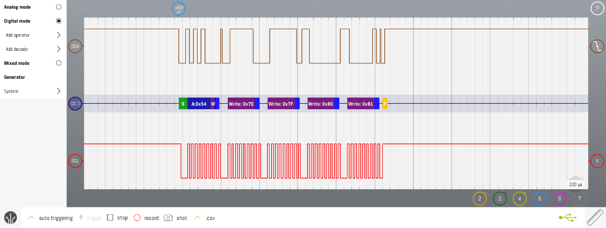

I created a simple demo that uses the i2c master and slave components.
I have the master as an Arduino Mega and the slave as an Arduino Nano - but this should work with any combination of boards.
Connect SDA, SCL and GND (a common ground is essential) I also added 10k pullups on SDA and SCL - but after getting things working I removed them and nothing seemed to break :-)
I also connected an oscilloscope (logic probe) with i2c decoding to help develop and debug the code. This was especially helpful checking for ACK/NACK (and I'm not sure I really understand the 'mask' property in the slave code.. I use 0 - which should match any address (I think?))
So - a rather 'rough and ready' example - the Nano (slave) receives the address byte sent by the master and then 4 data bytes (and it outputs these to UART) The master just outputs an address, followed by 4 data bytes (which are incremented by one each time) then delays for 1s and repeats.
I initially tried to output 'last byte' as true to stop the master - but didn't succeed - so here it just uses a loop counter. Looking at the trace - it seems to output ACK - even when last byte is set to true. This might be a bug in the component (or my code?)

I got this working reliably at 100kHz and 400kHz. At 1MHz it worked a while before stopping (I was surprised it worked as well as it did though)
I set the slave address (arbitrarily) as 0x54 - when transmitted this is shifted left one bit (with bit 0 set to 'read' data) - So here address displays in UART as 168 (0x54 x 2 in decimal)
One issue - i2c is fairly short range - UART might be a better fit if you want longer connections.

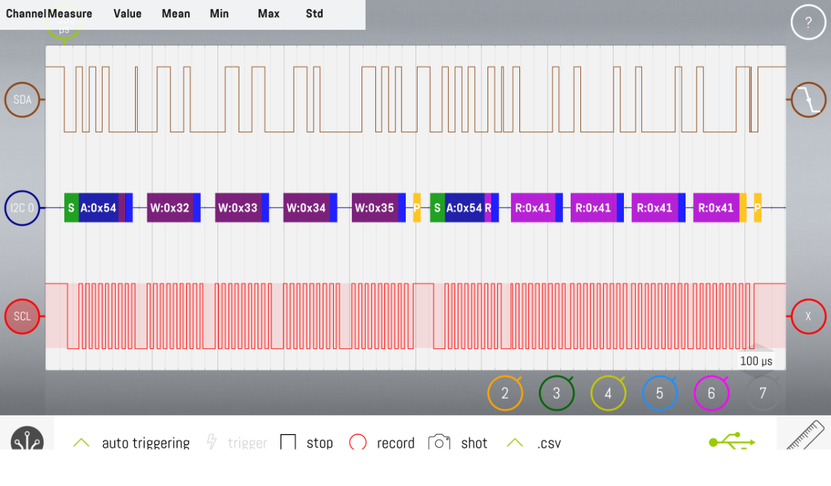

I've had one step forwards and one 'to the side'
So - having ascertained that transmit works AOK (for me :-) ) I rewrote the code to use the I2C CAL component and transactions )notice how this makes the code for the master much simpler) I also just use the scope here (and as smartscope has decided to crash on my PC I had to call in a tablet to run it (nothing going well today!)
I then added a 'read' that attempts to read 4 bytes This - sort of works. I tried with a loop - and also 4 individual calls to write - but the trace shows that the master just receives the same 4 bytes (first one sent!) However - I note that it does set ACK/NACK correctly..
So transmit works well (this on hardware - I haven't tried simulation) But receive (unless you want a single byte) doesn't. I suppose it would be possible to reply with individual bytes per read request and maintain a counter in the slave - but a bit of a kludge.

Not sure why this is happening - I tried a small delay after each byte and also using individual commands (start - tx, etc) without joy.
