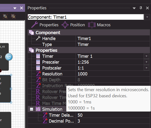

The timer and timed interval component should now work correctly with ESP32 hardware. Just be sure to use the latest library updates.

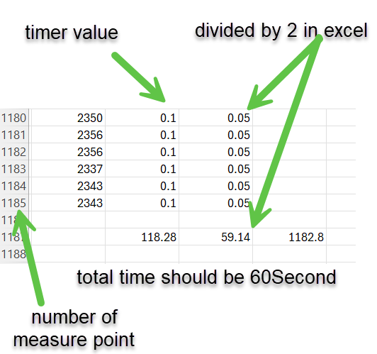

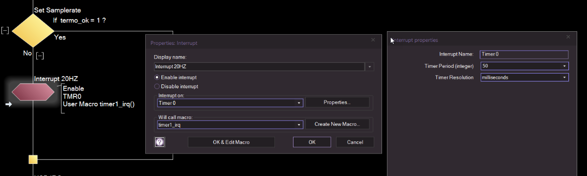

With an interrupt I sample with 50miliseconds.
I used the timer to test if my logger sample with 20Hz (0.05 sec)
The recording was about 1 minute. The timer shows a a time of 0.1second and a total time of 118 seconds!
But I get 1185 samples in 1 minutes. So I divided in excel the timer value by 2 and then it look very good.
would it be possible for the timer to run twice as fast as it should?
Excel result:
interrupt in the programm;

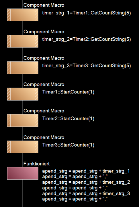

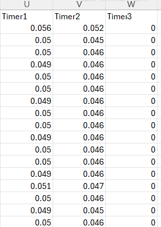

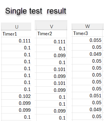

I tested all the tree timer.
That the time varies a little is not a problem but that sometimes the time is twice as long and that timer 3 sometimes works great but with the other two timer together, the timer 3 does not work
I set them in my sample macro so they should test the time between samples.
The correct time is 0.05 sec
First I tested each timer (turned off the another two):
Then I tested timer 1 and timer 2 together:
and then all tree timer together:
