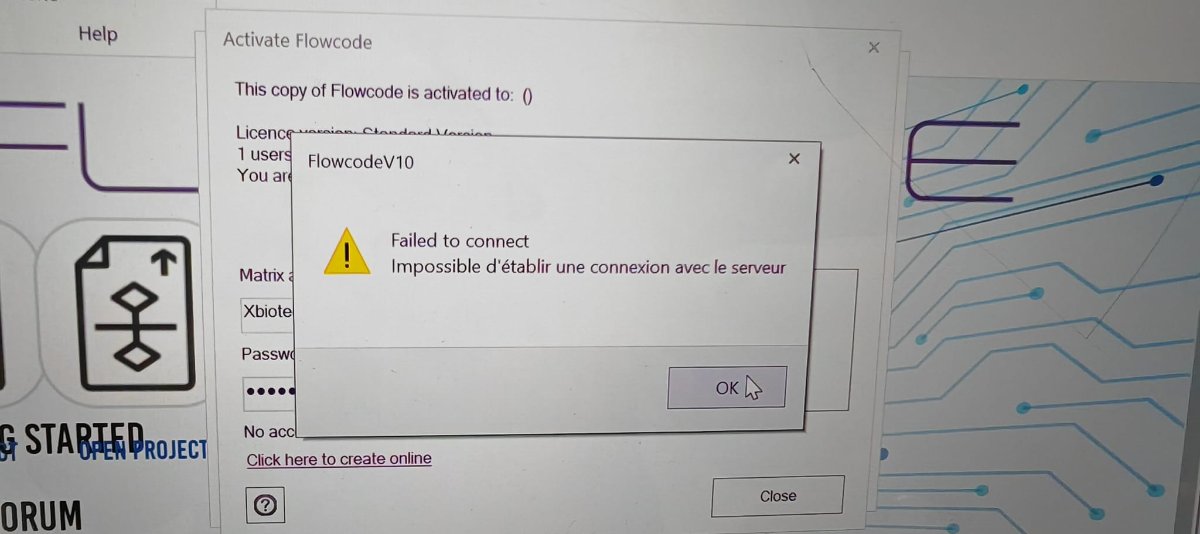

I just installed FC00 on my laptop and cannot activate it with the license
the line in French mean: "unable to establish connection with server"
Labtop Failed to connect.jpg (71.04 KiB) Viewed 5151 times
Win 11 + ESET
have you ever had this type of problem and how to solve it?

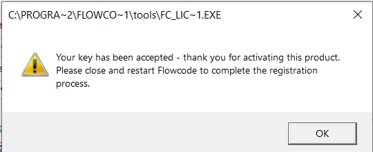

I have just tried and can activate Flowcode.
Key accepted.png (13.44 KiB) Viewed 5137 times
at least that is showing the issue is not with Matrix servers.
For some reason Flowcode is being blocked by a firewall or other third party from communicating with the matrix servers.

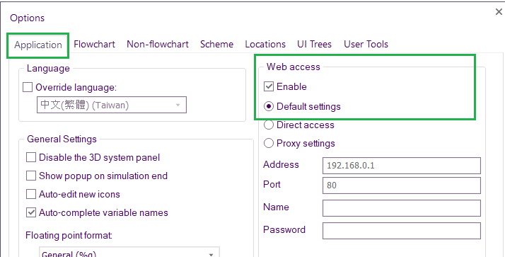

Within File > Global Settings, can you check the following settings match:
Global Settings.png (26.36 KiB) Viewed 5137 times
Do the library updates work ok or report a connection error?
after first install of FC10, I can not access to : File > Global Settings.
when FC10 start it open directly the page to add the licence
