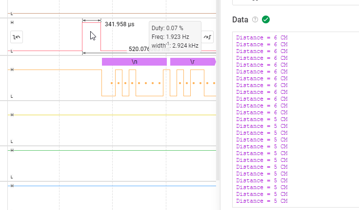

It's working for me on ESP32 with Use Timer = Yes.
HC SR06 Test1.png (43.39 KiB) Viewed 8066 times
AS the distance measured is 5.5cm, I would expect the result to be between 5 & 6

Hi Medelec35
Thanks a lot, my Hc-SR04 is now working with the esp32
:D :D
I can now finish up my Project.
