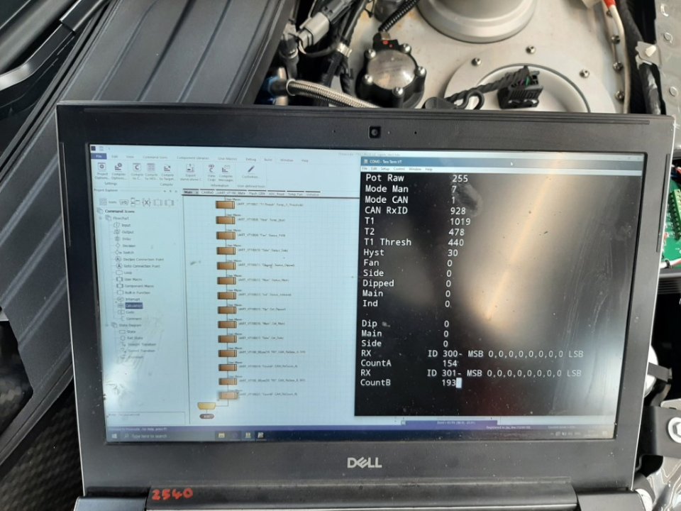

Outputing simple text strings works pretty well for me as a Field diagnostic feature. I think it was Martin who put me onto VT100
Integrating a simple subset of this with App Dev, could look pretty nifty!
I look forward to any progress you can make.

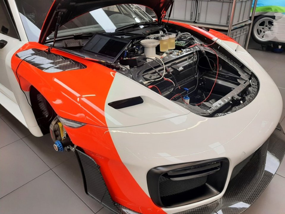

This was last week, using my current serial diagnostics for monitoring a couple of custom projects to solve a problem for a customer, using Pi PICOs to do some CAN juggling!
VT100 (Medium).jpg (111.33 KiB) Viewed 10871 times
At the customer (Medium).jpg (124.36 KiB) Viewed 10871 times

Ooh yes that looks like a brilliant setup :D thanks for sharing. What type of car is that?

Customer project car...as ever I'm covered by NDA's but its fair to say it will be making its first public appearance at Goodwood festival of speed. I think its a chunk above a mil! Trust me, there are lot of little FC based problem solvers running around in Racecars, Hypercars and LeMans 24H... :) J.
