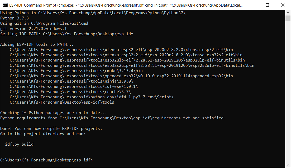

Posted: Mon Mar 08, 2021 3:16 pm
by stefan.erni
Hi Felix
It's look like this:
Re: ESP 32 Toolchain problem
Posted: Mon Mar 08, 2021 3:52 pm
by felixegger
Yes, I found it, but did not manage to run anything.
Please help again, Thanks
