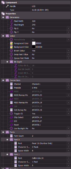

I used the display on this hardware with an ESP32 and it's working nice with flowcode.

This is the setup for the display:

It will likely update the display a lot faster if you enable the Queue Fast Pixels property.
Re: ILI 9488 and ESP32
Posted: Wed Jul 03, 2024 1:27 pm
by stefan.erni
I testet the "Queue Fast Pixels" property.
This is super! Very fast!
