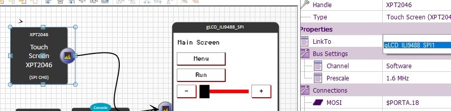

Hi Ryan,
In the properties of the touch component you didn't have the GLCD linked. this would stop the simulation touches from working.
With it linked it's now simulating correctly.

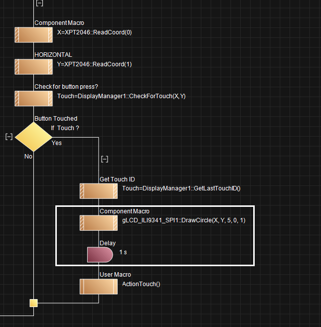

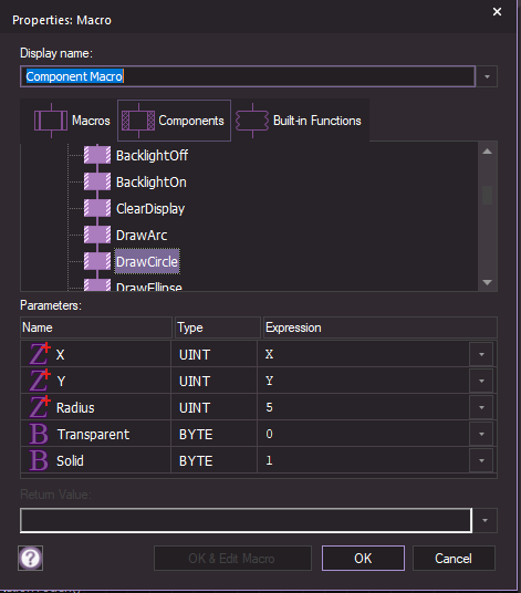

As a test can you add the following two icon to your project:
Touch test1.png (64.11 KiB) Viewed 5351 times
Check the circle produced, corresponds to where you touch.
