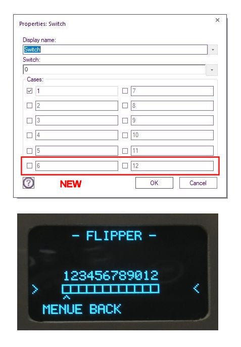

the switch is actual for a maximum of 10 possibilities decisions written. For a project I need 12 decisions. If you change it, may be to do it for 16 decisions to have some on spare.

Hello!
Workarounds are present. But it is easier programming with one variable for the decision.
SWITCH with 12 decisions.jpg (49.96 KiB) Viewed 13320 times
You see one oled screen with 12 possibles inputs you can choose. There are other screens where you can choose 12 inputs again. The program must know, where you are actual standing on the screen. To split into 2 varables is more complecated.

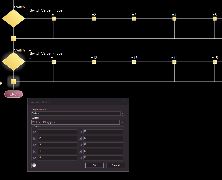

by stefan.erni
Hi Jorg
You can use the same variable in the switch.
You can also create 2 switch witch 6 position just choose the nummber.
it also has the advantage that the icon is not so wide
switch with 20 position

by mnfisher
switch(.x) 0..5 - first 6 options
switch(.x) 6..11 next 6 options
What happens for each option? For example if you set a variable to a value then a lookup table would be ideal.

Re: Switch with more decisions
Posted: Thu Aug 15, 2024 9:01 am
by mnfisher
Stefan types fast!
It depends how many options you have - 12 would be fine in two switches. Lots - I'd look at other routes - very large macros make for unreadable (and unmaintainable) code..

Posted: Thu Aug 15, 2024 11:38 am
by Jorg_Guldner
Hi ,
I thought, that the numbers are fix in the switch. To change them was a good solution for me.
Thanks to all.
