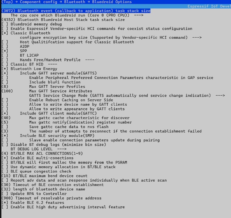

Here's is what I follow on getting mine to work. Follows these and you will work it out
>> On the BLE Configure image below mine is slightly different. I just follow what is there.
>> I then Read what BenR said
I save the image and then Copy the text to my laptop. For Future use like now.

by daddytims_tims
hi
This is how mine looks, just copy what is there.

But it still does not work.
I'm using the ESP IDF 5.3x (the most recent version at this moment) and some features like "Secure simple pairing" isn't available in my version of menuconfig.bat (or it is hidden?).
I can flash the program to the ESP32 but I can not find the device on any Bluetooth device (2 Android phones and my PC).
What am I doing wrong??
