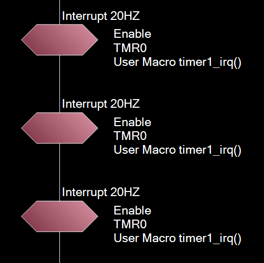

If I repeat the command 3 times it works much better.

the interrupt is more stable if I do the command several times:

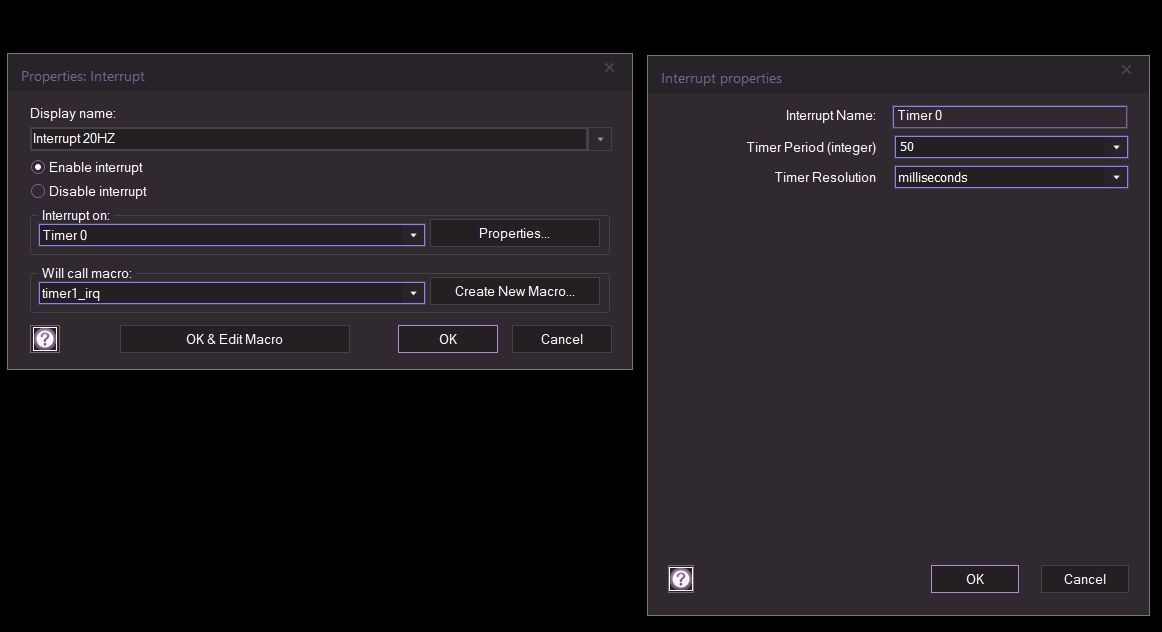

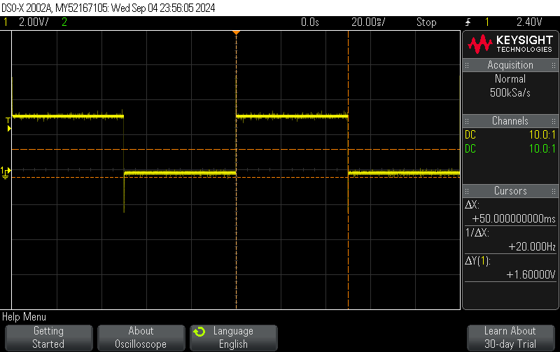

The interrupt works well and is easy to set.
It also works when I use 80Mhz or 200Mhz as ESP32 clock speed. I don't have to change the code.
When I use the interrupt for the first time it is perfect!

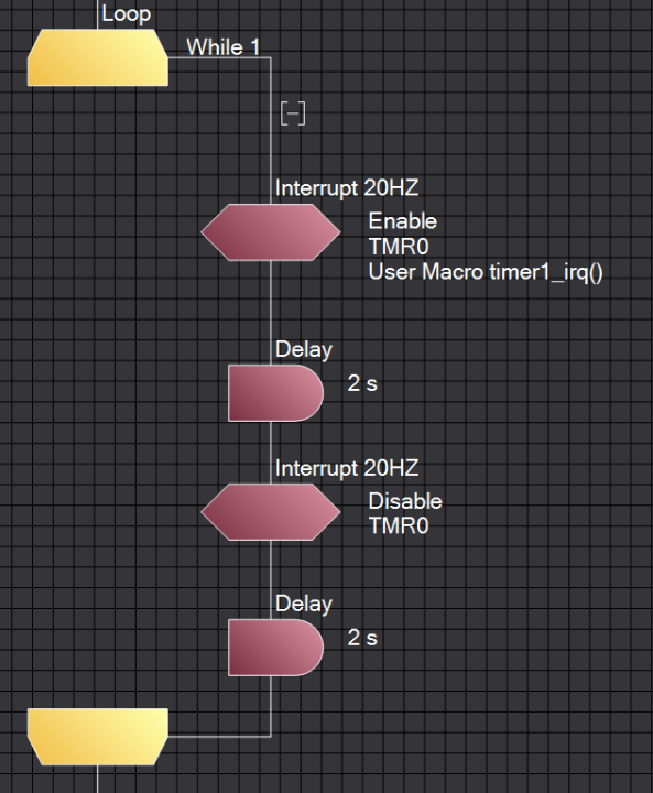

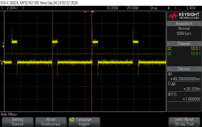

Only when i want to stop the interrupt it does not stop and then the second time i set it it, is already wrong and from the third time it is even worse but then it stays this bad.it triggers too many interrupts, so that makes my interrupt too fast

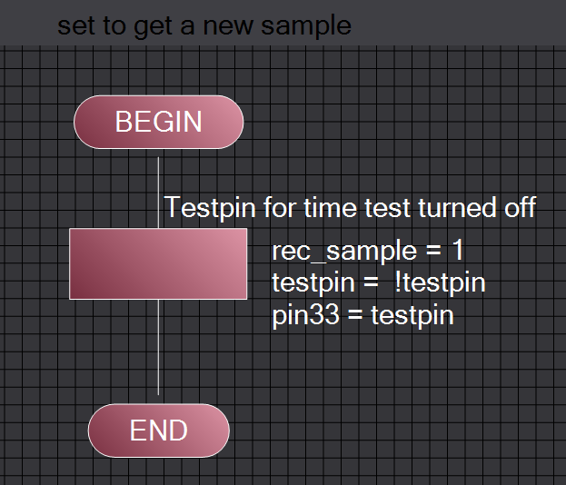

My test macro set on a pin33 for the osciloscope :
My testloop:

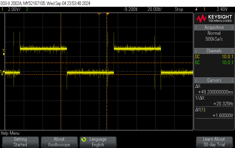

All the printscreen:
nice signal for the first 2 Seconds
Perfect!
after 2 second
should be switched off. But is not
Then later it's stable wrong:

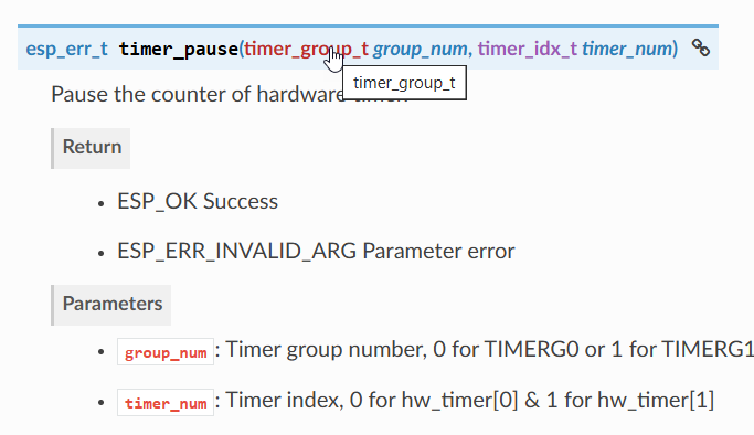

Could you try using timer_pause()
See https://docs.espressif.com/projects/esp ... tart%28%29.

I will test this soon. I found the fitting command and parameter.
timer_pause(timer_group_tgroup_num, timer_idx_ttimer_num)
How exactly are these parameters to be used?
just like this?
timer_pause(timer_group_t0,timer_idx_t0)
for Timer group number, 0
and Timer index, 0 for hw_timer[0]

timer_pause seems to be for the newer timer component :-(
