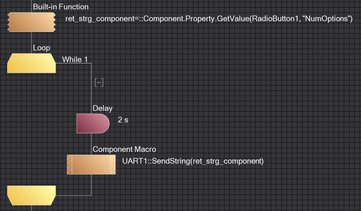

I would like to write the component propertis at the beginning of the Excel file.
Append string works with a text, but not with the build in function created string.
Does it work the way I program it?

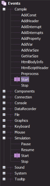

1) Click on a blank area of the panel to select the panel and in the properties window create properties to hold the values
2) Add a macro to the Compile Start event and to the Simulation Start event, this can be the same macro for both events
3) Inside the Compiler Start macro copy the value of the property you want to your local property
4) Reference the local properties in your program as you would variables

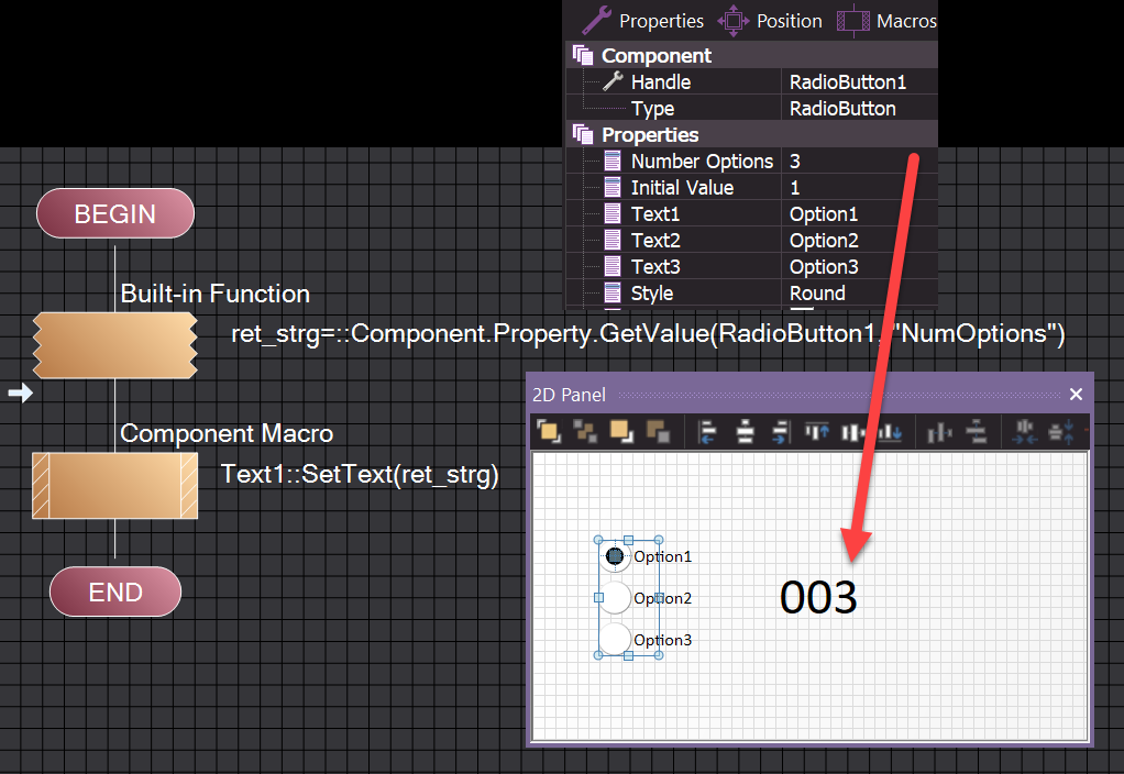

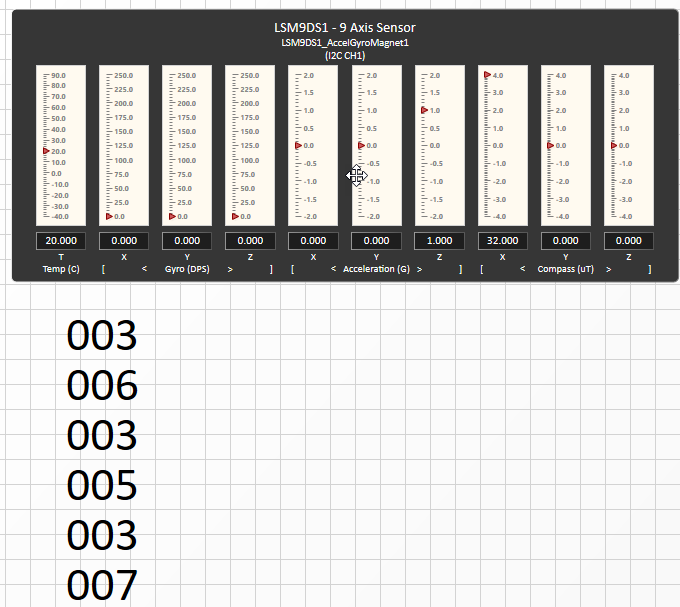

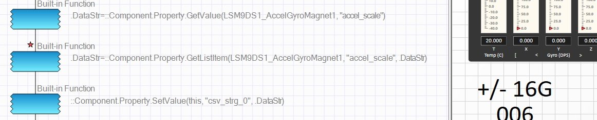

I have tried but I probably only get the index of the switch and not the text of the property
CSV_number_lsm9.fcfx
(25.93 KiB) Downloaded 513 times
Re: Write component property to sd-card
Posted: Fri Sep 13, 2024 1:22 pm
by BenR
GetValue returns the property value, if instead you want the label string then use the GetListItem function to get the label assigned to the value.

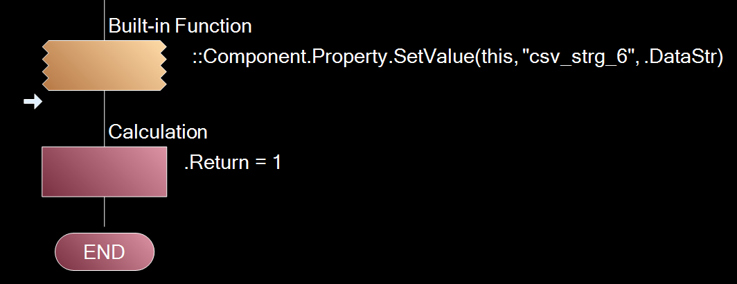

Unfortunately working only in the simulation. I cannot compile to hex. There is a fail.
CSV_post2.fcfx
(30.28 KiB) Downloaded 497 times
Posted: Fri Sep 13, 2024 4:09 pm
by BenR
Compiling now. Could be the sim event macro is missing a return value and the ESP32 compiler is complaining about that.
Just add a calculation saying .Return = 1
Posted: Fri Sep 13, 2024 4:27 pm
by stefan.erni
I add but still fail compile to hex. Sim is always ok
