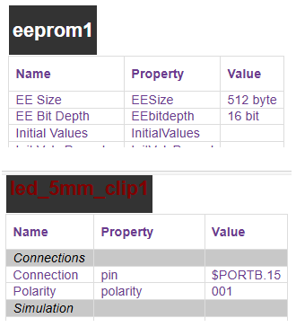

in the attached PDF you can see, what I found out.
Can you change by the way the color of the export text, which is dark red. It`s bad to read. A brighter color would be good there.
In the picture "Export info text.png" you can see what I mean.
Export info text.png (16.46 KiB) Viewed 11624 times

I cannot replicate what you are seeing, but I can maybe guess at what is happening.
It could be that a very large image of the flowchart is not correctly displayed when exported. Your workaround of collapsing some of the branches in the macro seems a good solution. Alternatively, you could consider splitting up the macro into smaller ones that are easier to view and manage.
The text colour and other styles of the export are held in the CSS file that accompanies the export (in the folder that is essentially "name_of_your_project_fcfx_files"). If you load the exported project info into a web browser, you should be able to right-click on the problem text and select "inspect". This will provide info on which CSS tags are used to set the data and you can then find and edit the CSS information in the file itself. If you need help with this, please post your project export files and I will take a look.
