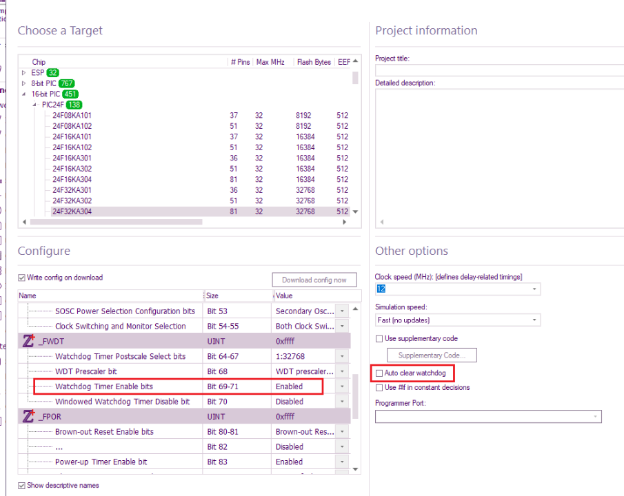

The reason I mentioned the 1 sec flasher is because you have Watchdog Timer Enabled set to yes, but you don't add C code Command icon or Autoclear watchdog enabled in Other Options, to clear the watchdog timer.
Config settings1.png (174.67 KiB) Viewed 5240 times
That would mean your hardware keeps resetting and not allowing the LCD to work.

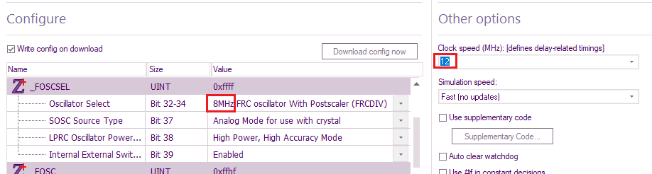

Also there looks like there is a mismatch between clock speed selection and Clock settings without a C ocde block to change clock speed on your hardware to match:
Config settings2.png (28.23 KiB) Viewed 5240 times
I'm surprised that the LED you have connected to your hardware cycles on and off at exactly one second.
