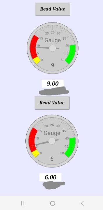

Posted: Sat Dec 14, 2024 1:53 am
by daddytims_tims
Hi Steve,
I am planning on upgrading my existing project from 2 GUAGES TO 6 GUAGES. that will require 6 buttons inside the web app
which it would be More effective if "1 BUTTON UPDATE ALL". Its (1) Esp32 with 6 sensors giving their separate readings.
I got the 2 gauges working with 2 buttons on the 26 October as Excepted.
2 button 2 guages.jpg (20.07 KiB) Viewed 16765 times
In that same week I had been playing around with "1 BUTTON TO UPDATE 2 GUAGE" trying to see if I could get it to work that way, seems as if it can't. Though my projects is working fine. I had to test out the product first before marketing it
So, 2 nights ago, I had a go at it again. trying to get it to work that way. When 1 Guage working the other Stop. Or the 2 of them update the 1 figure.
Seems as if it's not possible base on how I see it from my side.
So, I was wondering if it's even possible to have a 1 button update ALL GUAGES?
Ryan
Re: WEB APP HTTP Protocol
Posted: Sat Dec 14, 2024 12:25 pm
by Steve-Matrix
It's definitely possible and you have a few choices. You could have one button that does a single fetch and that fetch returns with a set of data for all gauges. This will need the embedded app to be changed so it replies with appropriate data. Or your single button could send out multiple fetches that each are processed separately.
