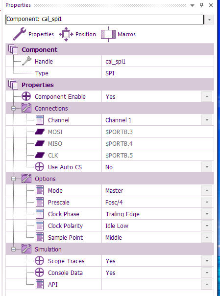

With Channel 1 selected within your project to check SPI is the same as my settings, try this.
View menu then select Component debugger.
Select Expose full component tree in property pane.
You can close the Component debugger.
Within Properties scroll down to cal_spi1 (it's a fair way down!)
Check the settings are:
cal_spi settings.png (45.2 KiB) Viewed 10206 times
If for example Clock Phase is set for leaning edge then the display won't work on the Uno.
Also speed will be an issue for level shifters.
You ideally want the presale as /4.
I'm not sure if your level shifter will work with the SPI speed?
It works in software mode as the speed is a lot slower.
My suggestion, lvl shifts at up to 32 MHz ok as it also works on ESP32, even though its not required.
