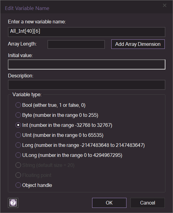

When working with 3D data, it is convenient to work with multidimensional arrays.
For example, in an array data[40 ][6]
I can have 40 positions with two objects x1, y1, z1, x2, y2, z2,
This actually works very well with Flowcode.
And simple arrays can already be sent and received very well with Flowcode by USB or Bluetooth
One question, can I also send this multidimensional arrays with USB as multidimensional arrays?
There is a small problem..
Creating is easy, just press add array dimension twice

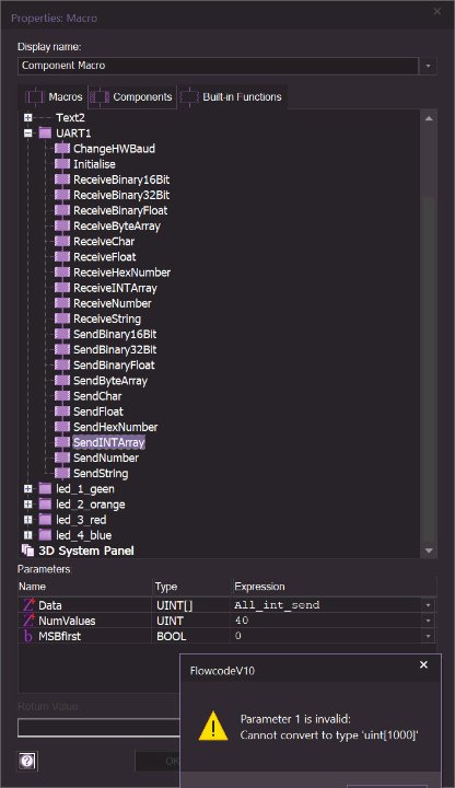

Plan B. Cheat - a multidimensional array is held in memory as a contiguous block of memory - so data[2][2] will allocate 4 * size of cell (at least in C)
So using a line of C, you could pass the address of the data and the size to SendIntArray - the address is FCV_DATA or FCL_DATA (for a local)
The problem is that the name of SendIntArray will be rather longer and include the component - so you need to get this from viewing the C code...
The receive can work with either receiving a dimension at a time in a loop as above or using a C block and the address in the ReceiveIntArray as per the send...

There are a couple of disabled macros at the start of main - if you delete these, the code optimiser deletes the SendIntArray and ReceiveIntArray macros - the start of main isn't necessarily the best place (and they could be anywhere - or are not needed if you use either macro elsewhere)
If you look at the Send and Receive macros - the name for Send/ReceiveIntArray is mangled to FCD_047b1_UART1__Send/ReceiveINTArray and this will change if a new version of the component is released :(

I have looked at your suggestion and in the APP it is the comport instead of the uart.
I changed that and installed it.
But then the app doesn't understand any C code :)
FCD_047b1_UART1__ReceiveINTArray((void *)FCL_DATA, FCL_ELEMENTS, FCL_ELEMENTS, 1, 100);
Re: Sending multidimensional arrays by USB
Posted: Thu Nov 28, 2024 3:36 pm
by mnfisher
Yes - sorry forgot you were sending to an App - it doesn't use C. So slightly stymied that end.
So the MCU can send all as one - but the app will need to receive differently - so can either receive as a single dimension array and calculate pos or receive in a loop(s) incrementing x and y (and z in the 3d case) as appropriate
