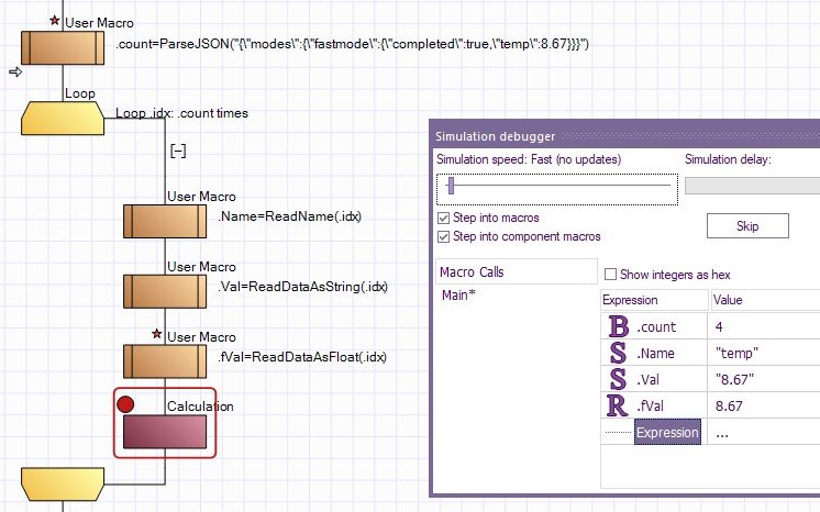

A small question about this macro still remains: when I retrieve the value for "temp" as a Float, it only shows the first digit, not the decimals..
Another thing to look into? When I retrieve it as a string it is shown completely.

Just checked the component source and ReadDataAsFloat seems to be working ok for me. What chip type are you using and I'll test again on there just to check it's not a specific CAL/toolchain issue.
Screenshot 2024-12-02 213912.jpg (69.04 KiB) Viewed 9968 times
