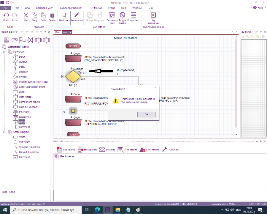

It doesn't work for me. It's impossible to check in general. Maybe Matrix will do capture and comparison and embed it into the FC10 body? Useful tool

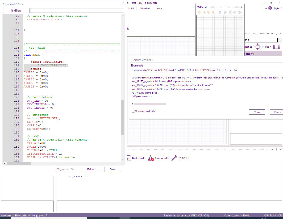

Thank you. Just wonderful! Another error gone. Now we just have to defeat this one;
TRISA=0;
PORTA=0;
T1CON=0x01
INTCONbits.PEIE=1;
PIE1bits.CCP1IE=1;
Compiler err
143: TRISA=0;
^ (195) expression syntax
146: INTCONbits.PEIE=1;
(908) exit status = 1
I noticed that such insertions in C change the main code created by the standard method Flowcode . {} ; are moved

Missing semicolon after T1CON = 0x01
Note the 'bits' refers to bitfields not individual bits.
So
REGISTERbits.FIELD = 0b110;
Will set 3 bits (assuming FIELD is 3 bits wide)
