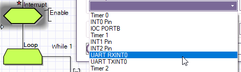

If I was you , I would use either UART RX interrupt
Rx Interrupt.png (13.57 KiB) Viewed 8681 times
Or use UART software timer as that also uses interrupts.
Either way you will no longer have any missed characters.
There is even a circular buffer available.
That will store the received chars until they are required.
For a great example on the best way download this flowchart.
as it also shows you how to set up the RX interrupt as well as circular buffer.
Let us know if you require further help.

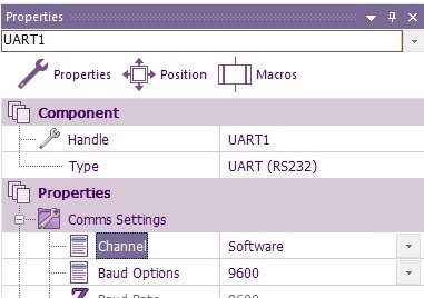

In your v9 program you are using the software UART. Can you try the hardware UART channel instead.
Software UARTs can be a pain to get bang on the nose whereas a hardware UART can easily do this.
If you need to use a software UART then can I suggest you instead use the UART Software (Timer) component. This uses a timer interrupt to allow you to get the timings just right.
