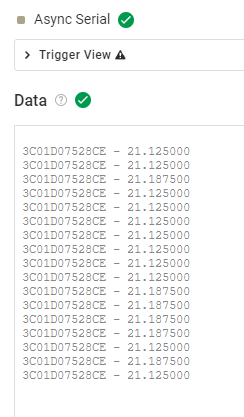

I have just tried DS18B20 on the Uno and 18F18877 (running with internal osc at 32MHz) and no issues at all.
DS18B20 Uno UART.png (11.06 KiB) Viewed 3190 times
For that reason, moving this topic from bugs to General, as there must be an issue with your setup.
Can you try selecting DS18B20 properties, and check that LinkTo drop down box is not blank.
If is, select One_Wire1 and recompile.
