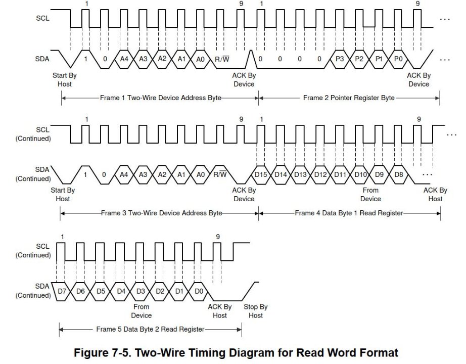

The temperature register of the TMP1075 is a 12-bit, read-only register that stores the result of the most recent
conversion (address 0x00). Data is represented in binary two's complement format. The first 12 bits are used
to indicate temperature, with all remaining bits equal to zero.

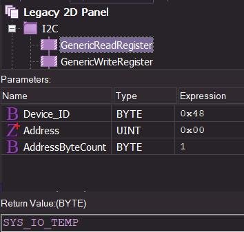

I have been using the GenericReadRegister call which is great as it's just 1 entry and works all the time. This is true for 1 byte readmm, but how do I read 2 bytes?

I think you need to use Transaction Mode with an ESP. The WiKi has some information

I'm trying to achieve this workflow to read 2 bytes (one word):

Been a while since I used I2C (especially on an ESP) so this is just generic of what I think needs doing.
You need to use Transactions with the ESP and you will need to create a Byte Array to receive the data.
Use the Transaction Initialise to set the address
Then Transaction Read to grab the data. In here you specify the number of bytes to read into your array
Then Transaction Uninitialise
Once you have the two bytes in your array you need to convert into a 16-bit number.
Say your array was Rx[] and you had an integer variable called Result
Result = Rx[0] will load the first byte (MSB) into variable Result. Shift that left by eight positions (Result = Result <<8) then add the second byte (LSB) (Result = Result + Rx[1]. Hopefully this should now give you your value.

Create a byte array of size two bytes, example Data[2]
Call Transaction Initialise(Address) with the Address of the device. This is in the range 0x40 to 0x5F.
(This only needs to be done once)
Set the Pointer Register value, example Data[0] = 0
Call Transaction_Write(Data, 1) to set the pointer address.
Call Transaction_Read(Data, 2) to get the two byte result, into the Data array.
Data[0] will contain the high byte, Data[1] the low byte, which you can combine to give your integer result.
