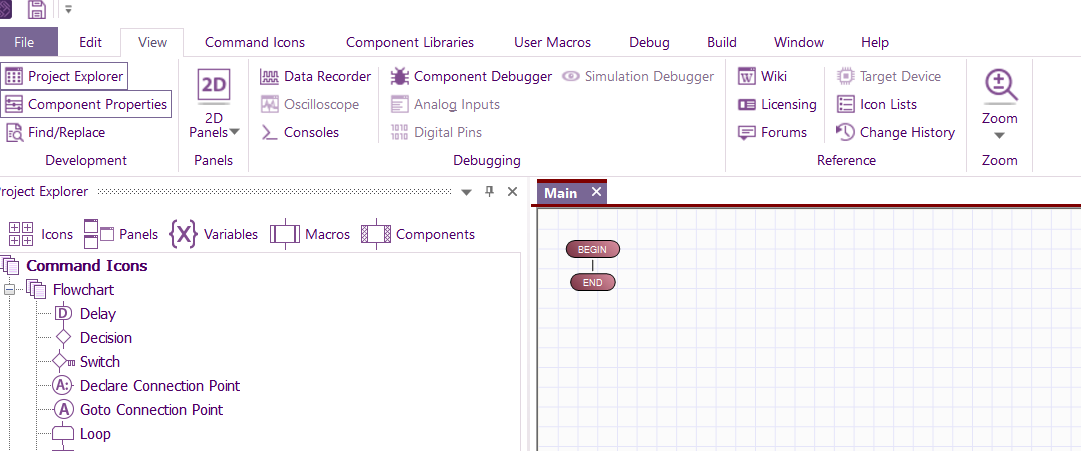

Where is the Webpage Design panel?
Posted: Tue Jan 14, 2025 5:23 pm
by MJU20
I've started with this tutorial: https://www.flowcode.co.uk/wiki/index.p ... an_API_URL and stopped after a few minutes because I can't find the Webpage Design.
In my view there isn't a Webpage Design page so according to the tutorial: "If you can't see the 2D Web design panel, select View > Webpage Design"
But I can't find out how to add a webpage design page from the view tab.
My project has the .fcsx extention..
Please point me the right direction ;-)

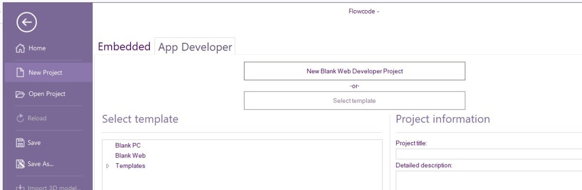

I might be wrong but I think you need to choose "App Developer > Blank Web" when creating a New Project.
Screenshot 2025-01-14 175936.jpg (39.72 KiB) Viewed 34335 times
Hope this helps.

Thanks Chipfryer27.
I did that and as I wrote in my initial post I get the *.fcsx extention..
But can't find the panel.
Do I need extra licences??? This is something that I think off just now.
It isn't mentioned in the Wikipage.

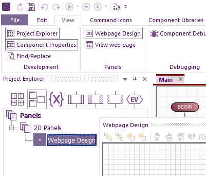

by Steve-Matrix
The .fcsx extension is used by PC Developer and Web Developer projects, but only a Web Developer project will have the "Webpage Design" panel.
When you create a new (or load an existing) Web Developer project, you will see a single 2D panel:
Webpage design panel.png (24.77 KiB) Viewed 34271 times

by MJU20
Thanks Steve for the tip, it does work!
I followed all the steps in the wiki carefully, but somehow still managed to overlook something.
It’s not the first time that’s happened to me... :oops:
