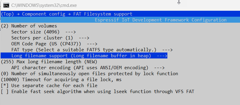

I changed the menu config and now it works again.

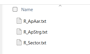

I test far and append string works perfect.
I still have problems with writing the sector.
The file remains empty.

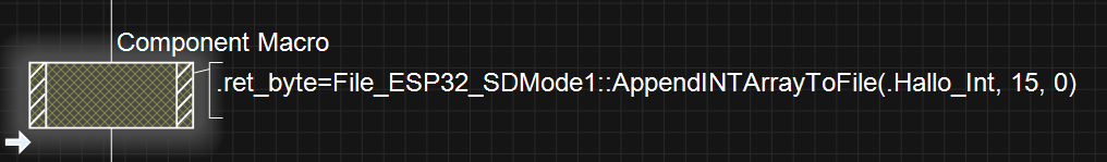

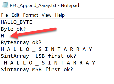

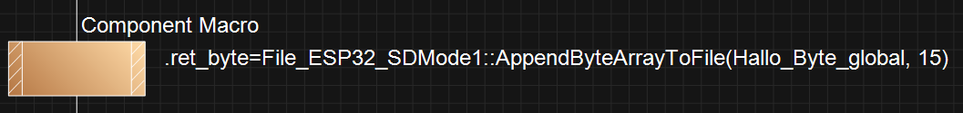

But a few commands don't seem to work properly yet
- local array append give problems to compile, you can see when you activate them in the macro, but with global array it compiles.
- AppendByteArray is appending just one letter

There is still a small problem. I use the option long filename support. This option must also be selected in the menu. If this is not done, my test will not work for you. I have changed the longname to a short in the test program.
program with shortname:
Test_SD_post_ShortName.fcfx
(50.38 KiB) Downloaded 353 times
with shortname:
program with longname need a change in menue:

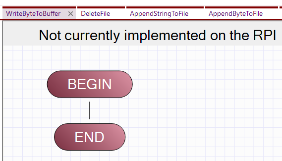

Re: ESP32 4Bit SD-Mode Init problem
Posted: Thu Feb 20, 2025 4:30 pm
by stefan.erni
Hi Martin

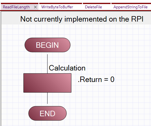

I have looked at the component and WriteByteToBuffer, ReadFileLength do not work and are perhaps not yet implemented,
or I still don't understand exactly how it works.
During the test I did not notice any difference if I change the clock from 20MHz to 40Mhz.
Also no difference if I choose 4bit or 1bit mode. Both equally fast
from component WriteByteToBuffer:
from component ReadFileLength:
