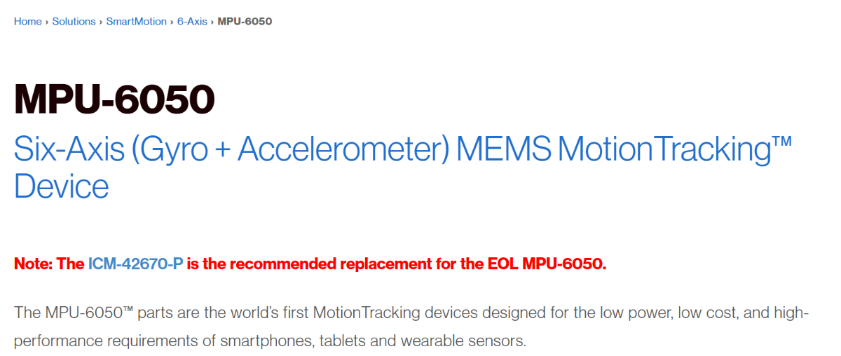

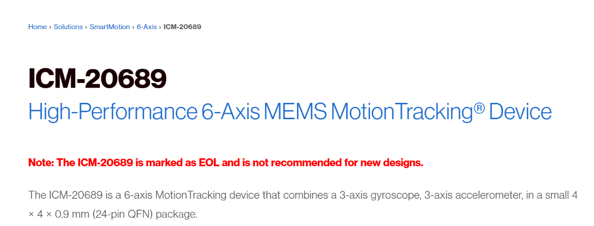

There is a good overview of the TDK sensors. Which type and specifications
https://invensense.tdk.com/products/mot ... ng/6-axis/
but which is the current sensor ?
