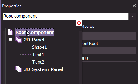

Step 4. I don't seem to be able to find a reference to "root component"
Re: Components creation in Version 10
Posted: Sun Feb 09, 2025 10:54 pm
by medelec35
When a part of a component is exposed e.g. the colour property, then it will show on the Root Component.
To view all exposed properties on the Root Component, you select the dropdown of properties ,then left click on Root Component at the top.
Root component.png (12.63 KiB) Viewed 10412 times
