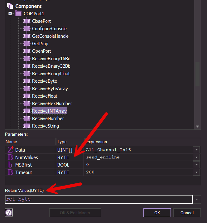

With the App Developper Comport receive IntArray I can just receive 255 Byte because the length is probably one byte instead of one Int size
With the uart in the hardware I can sende longer integer array
Can this be extended if it is not a big effort?
App receive just smaller array:
Hardware send big aaray:

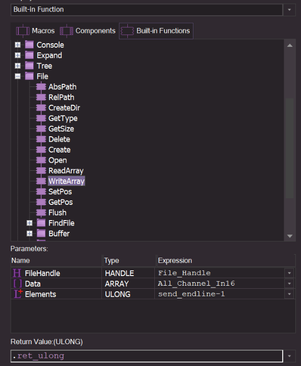

It is very easy and comfortable to send data array from processor to app and save it into a file. If these are integer array I can create wavefile very easily. I just have to create the header and it works. But unfortunately the appdevelopper can only receive small arrays. probably this makes my transfer too slow. would it be possible to extend this? or is there a better option?
Save to wave file is ok:

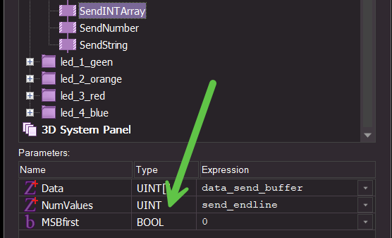

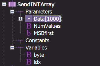

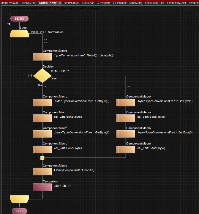

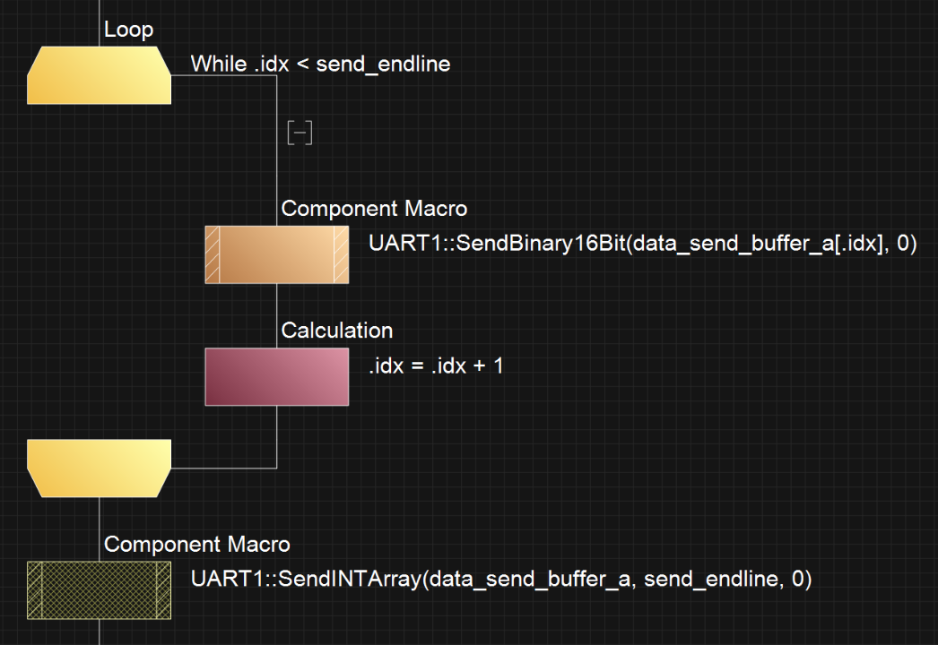

It looks like sending an array with the component uart is also limited to a byte value. I already have problems with sending
even if I can enter an integer value.
Component:

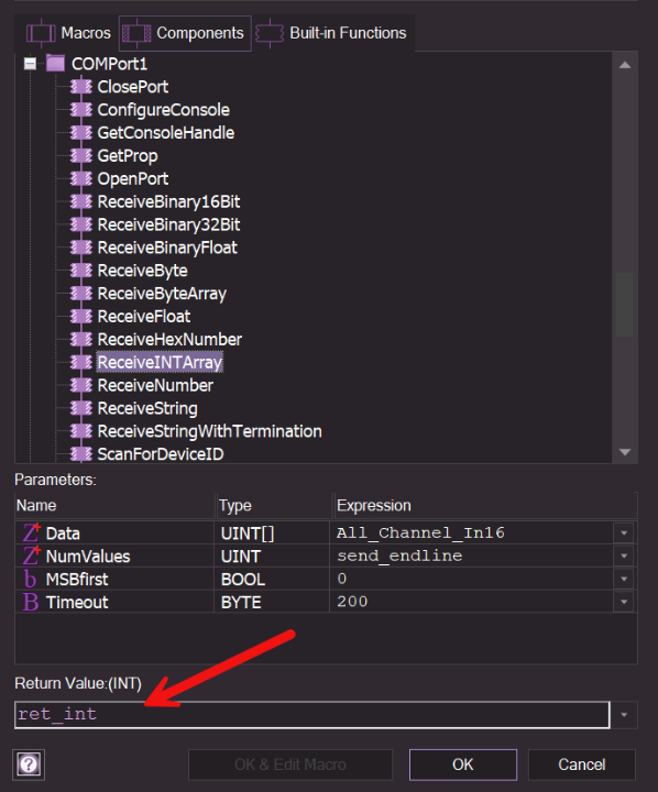

APPDEVELOPPER:
Yes perfect! It's working now to receive bigger array than 255 values.
I have to be a little careful now it's no longer ret_byte now it's ret_int :)

stefan.erni wrote: ↑
Wed Apr 09, 2025 9:32 am
APPDEVELOPPER:
That's great, sounds like you are happy with the changes.
Yes , it made sense as if you are using a count of more than 255 numbers, then the value returned of Course should be a UInt or int.
In the release version probably better as UInt.

Maybe you could take this opportunity to change the other component on the embedded board.
I will test and post the result here again
component on the embedded board:
