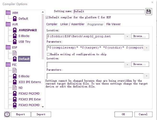

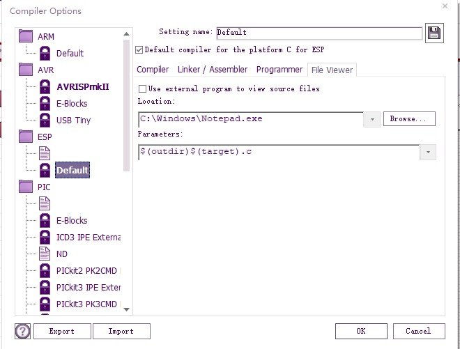

ESP Compilation error.help me please!
Posted: Sat Mar 29, 2025 1:45 am
by 17712885438
ESP32 Compilation error.txt
(5.97 KiB) Downloaded 371 times
Re: ESP Compilation error.help me please!
Posted: Sat Mar 29, 2025 2:32 pm
by medelec35
Anyone that has compile error would save time by proving the .fcfx, .msg.txt & .c files as it saves us asking for them.
My suggestion is test your toolchain set up by compiling using a Lolin32_lite target.
just create a basic test project, e.g. add a loop then within the loop, Output gpio 0 high, Delay 1 second, Output gpio 0 , Delay 1 second.
It does not matter if you don't have a lolin32 target device as you are only using compile to hex and not compile to target.
If compiles OK then we are looking at a esp32 C3 issue, so we will require all requested files.
If the Lolin32 does not compile to hex then we need to deal with that first.
Can you let me know the results, please.
