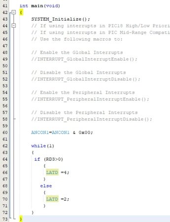

Hi Martin,
I made the same project with MPLAB X 6.25 as the one I attached in Flowcode.
D3 bit input, D2, D1 bits outputs, the Compiler XC8 v2.50.
It works, so I think the relationship between the Compiler and the PIC18F46K80 processor is fine.
You wrote that the test program written in Flowcode worked with a PIC18F47K40 MCU.
That is, the D3 bit worked in input mode!
For this, the analog mode must be disabled on the given port bit.
The analog mode is enabled and disabled in the case of the PIC18F47K40 with the ANSELx registers as usual,
while in the case of the PIC18F46K80 with the ANCONx registers. The bits in the ANCON register are called ANSELx.
Could this difference be causing the problem?
Sasi

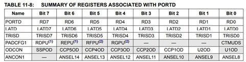

PIC18F46K80 PORTD.jpg (23.48 KiB) Viewed 5059 times

I tested which ANCON1 bit disables the analog input from port D3 (Comparator input)
and it is not ANSEL11 (ANCON1 3rd bit) but ANSEL14 (ANCON1 6th bit). :?
I tested with XC8 v2.50 and v2.46.
