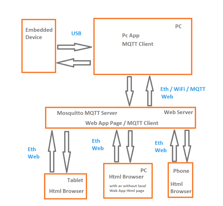

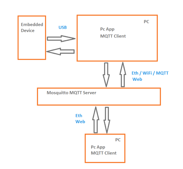

Our projects are like this schematic but in place of Web App, I ask me if we can have also a second Pc App with MQTT client.

So, many questions before design the web controller App to choice the best way.

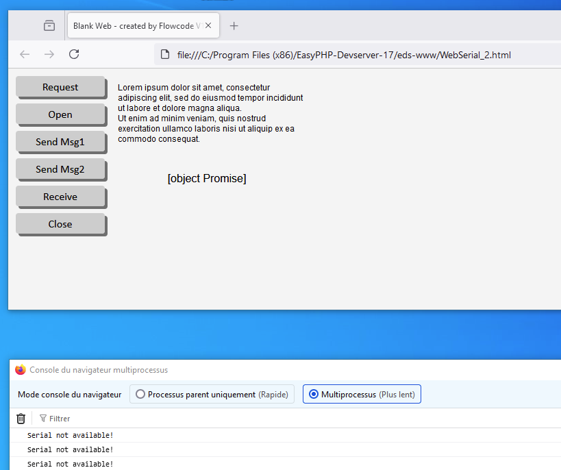

I tried Serial COM Port example Web App the last night, but it don't work. I have error message "Serial not available" in the console. I added Text to see the result of the Request button but I obtain only "object Promise" message. As this component is only a Beta version I don't lost more time with this component.

About the web control, I think design a connection Web page with MySQL database. After that, connected user can select the target device in a list and control the device like this from a PC: Pc App -> Mosquitto -> Pc App -> USB -> Embedded device.
To use a tablet or a phone I must also design this solution: Web App -> Mosquitto -> Pc App -> USB -> Embedded device.
Thank you again for your great job, it help me good to understand how to design a MQTT broker.

"Serial not available" sounds a bit like an incorrect com port has been selected. Does it give you options?

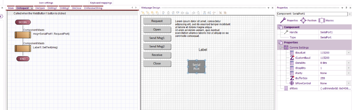

In fact I don't understand how select the number of the Port Com with this component. If I understand good, the "RequestPort" function select the port number per VID / PID.
I restricted the list to obtain connection only with my VID PID in the Filter properties. But with or without this parameter, I have also the same error. Embedded device is connected and linked on port com 14.

Have you tried other browsers? The Serial API is relatively new and some browsers might not fully support it. When I created that Web Developer Serial component, I did most of my testing on Chrome on a PC. I've not done much with Firefox.
Another issue is there are a few different ways for virtual COM ports to be 'known' by the OS. If the browser is not detecting your serial device, then it might be using a serial driver that is not fully compatible with the Serial API.
