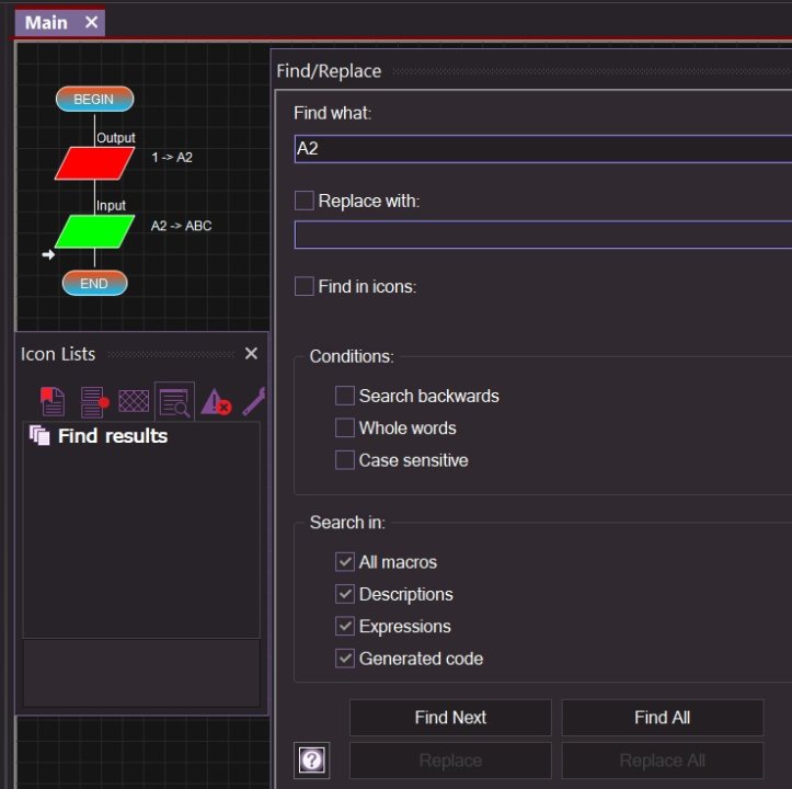

In Flowcode10, the Find/Replace command in the View Menu currently does not return any search results
when searching for a Port bit used by an INPUT or OUTPUT component.

By future release do you mean Flowcode11 or a patch for Flowcode10?
As I recall, this command worked flawlessly a year ago.
Sasi

It looks like port and pin values in the i/o commands were never checked during a search, so I think this is a long-standing problem.
We have no current plans for an update patch for the v10 release.

Hi Steve,
Thanks for the replies.
I used this feature regularly and still use it in Flowcode8 and 9.
In my Flowcode10 project from a year ago, there are also signs that I was using the Find/Replace feature to search for portbits.
It's possible that it broken after installing the v10.1.2 patch.
This bug is not a big problem, it's just less comfortable to use it that way.
Regards,
Sasi

I just checked and the initial release of v10 also has this problem. Although it was working on in v9.
I have found and fixed the issue, so a future release of Flowcode should not have this problem.
