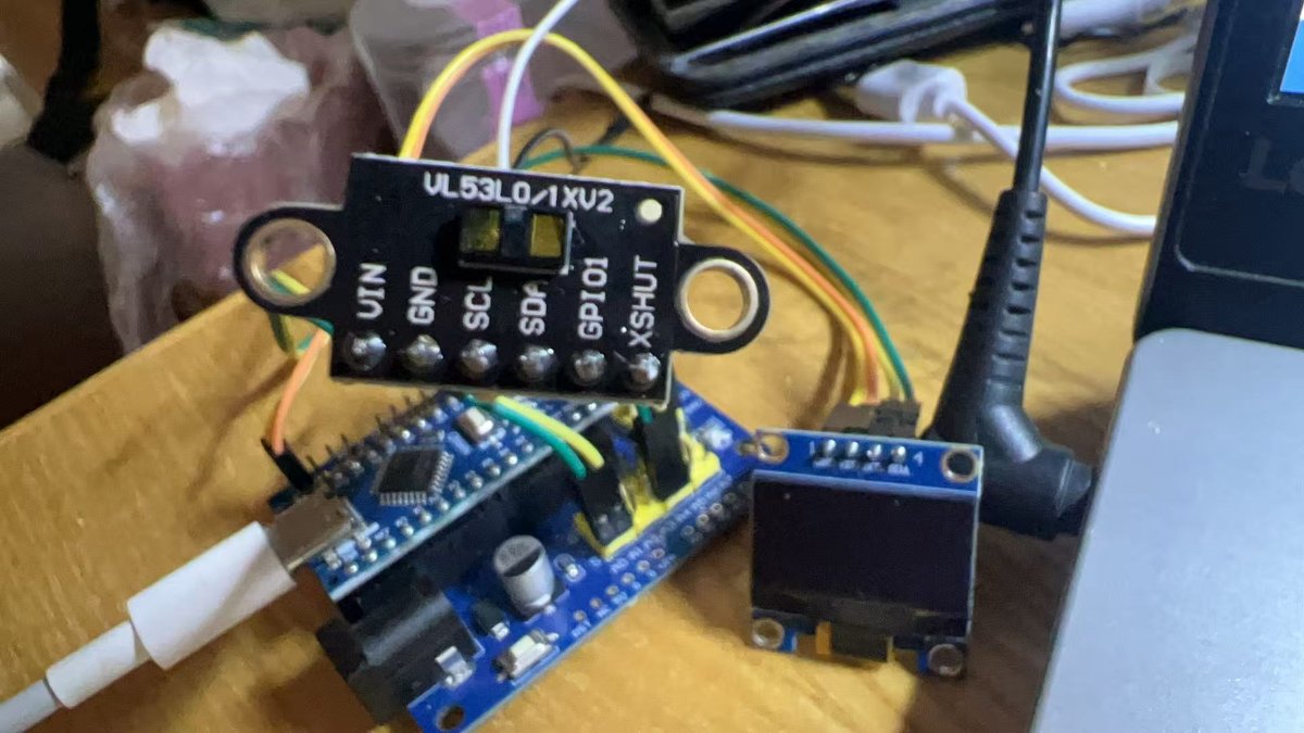

VL53L0X V2.jpg (125.85 KiB) Viewed 4255 times
Is this model correct?

Without seeing a datasheet I can only guess that it is perhaps "latest generation" of the device and if so I would again guess that it would retain compatibility with original (perhaps with extra features).
There are many "clones" available from the usual cheap sites and some of them are of poor quality. In the tests I did on a couple I did not get anything like the claimed accuracy, but it was still perfectly good for my application.

The TOF sensor in the picture is a VL53L1X type which is pin compatible with the VL53L0X type.
But it probably won't work with the VL53L0X API.

I got curious so I tried to test. I have the same one as 17712885438 have. In my experiment I have used an I2C LCD display connected to C4 and C5 same for the sensor. I have another model VLX also and both work ;)
You could try to change the display in my examble and see if it work.
Good luck :)
