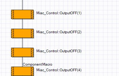

I am not sure if it is me or some bug however I set the color of the component macro icon to as below.
Then after closing FC and open it again the next day to work the color has change itself :D

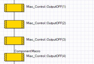

as below

Just a note if you change the color scheme and place a macro on the FC chart it has the new scheme however if you copy that same macro(new color macro) and paste it to the flow chart it also change color. This happened a few times however this morning it seems to be ok again, :D

I think I see what the problem is. When a "component macro" or "simulation macro" icon is copied, it takes the colour of the "user macro" icon. In a similar way, a copied "declare connection point" icon takes the colour of a "goto connection point" icon.
I should have a fix for this when the next update is issued.

There is a workaround until the fix is available. Simply open "Global Options" and then click "Cancel" and the icon colours will display correctly.
