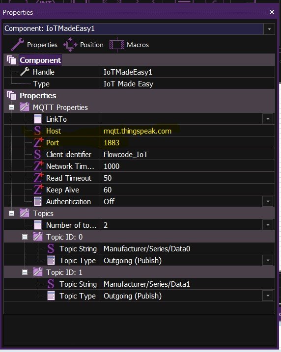

Under IOTMadeEasy properties you can set the server name and port, highlighted yellow in this screenshot
Screenshot 2025-06-24 165111.jpg (75.38 KiB) Viewed 4777 times

During code generation, the value (or string) you enter is compiled into a constant scoped to that specific component handle.
Because it’s scoped, identical property names never clash.
It doesn’t matter how many Host properties you create, by adding additional IotMadeEasy components —on the embedded hardware each one becomes a unique constant tied to its own component instance.

So it turns out that it is impossible to access the component properties as variables? Only statically write data in the component properties?
