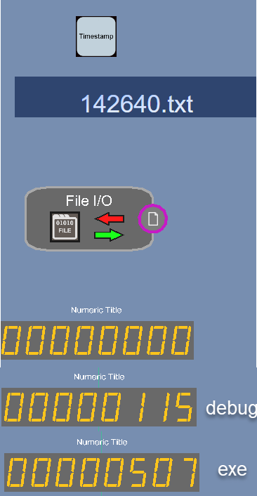

I wrote a little App for a speedtest for the disk
and tested debug mode and exe mod.
writing Total (51,200,000 bytes)
In debug it's need 115 Sec for 50Mega file = 434kByte/sec
In exe it's need 507 Sec for 50Mega file = 98kByte/sec

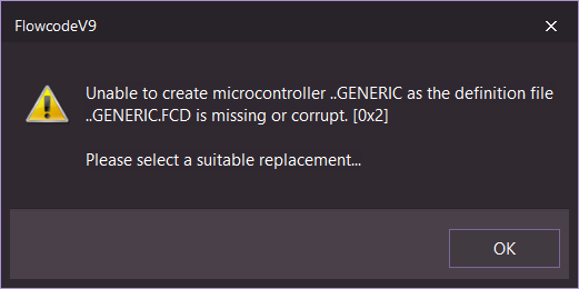

Then later I get an error while opening the App again.

Hi Stefan,
Yes I had the same massage.

Does this fix the problem?
FC9_APP_Speedtest.fcsx
(16.05 KiB) Downloaded 991 times
Not sure what's causing this but please let us know if it happens again.

by stefan.erni
Yes it's working again

by stefan.erni
but if I press this button I have again the error.
