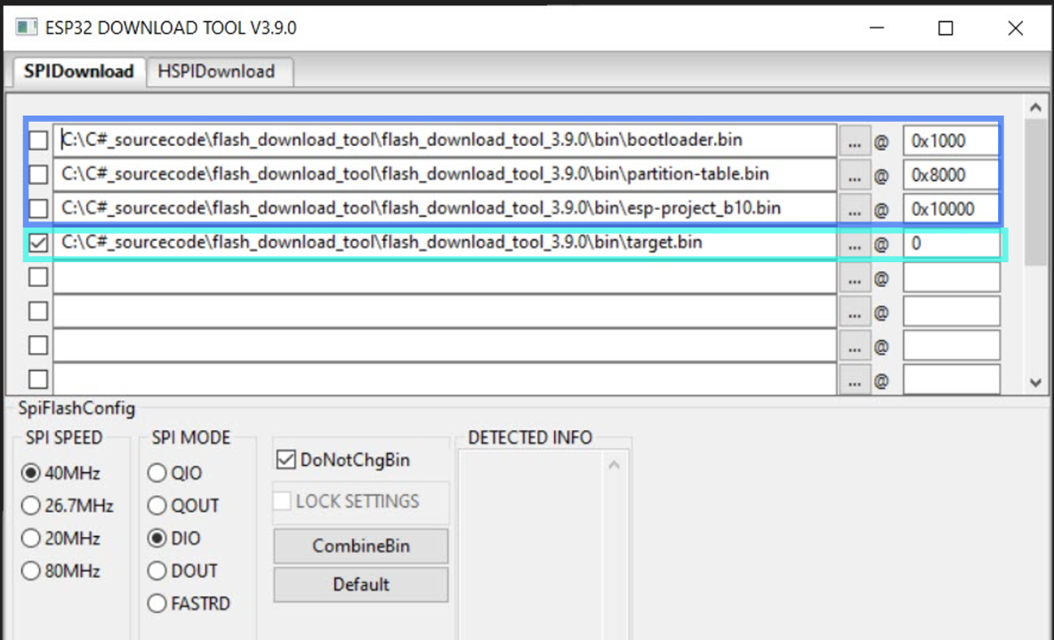

Hello. I created a flowchart for the ESP32-WROOM-32 module using FlowCode. I need to send the file to someone who doesn't have FlowCode so they can flash an ESP32 module. I tried using the 'ESP32 FLASH DOWNLOAD TOOL' software to write the .bin file to memory, but after burning, the code doesn't run correctly. I would like some help to get this done correctly.

The start address depends on the partition table used.
I think the default is 0x10000 not 0x1000 - so try the different address

Hi Silva, Hi Martin
Either load 3 files (blue version) or
assemble bootloader+partition+Flowcode .bin beforehand. (green version)
