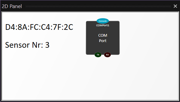

Re: ESP32 how to read the MAC Adress
Posted: Fri Oct 24, 2025 2:16 pm
by mnfisher
Hi Stefan,
Default string size is 20 - and if somewhere there is a 'make a copy' box checked that might explain things? Passing strings by reference (not copying them) is usually the preferred option - and quicker too - but the default seems to be to pass by value.
Posted: Fri Oct 24, 2025 3:07 pm
by stefan.erni
Hi Martin
Yes, I haven't made all the strings that long now.
And it's working nice.

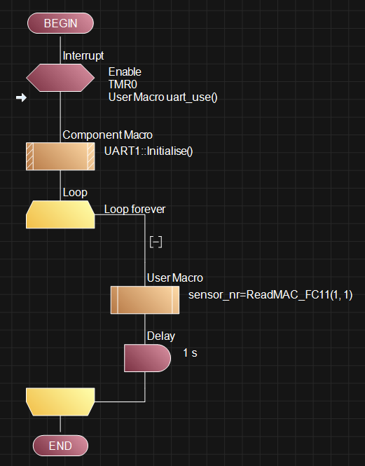

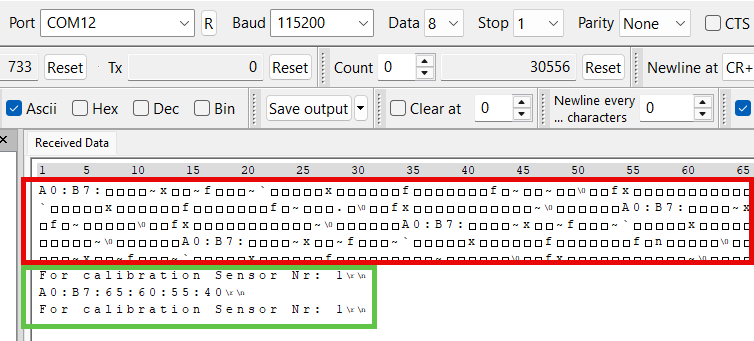

But I have a small issue with the UART.
The red data is without a interrupt, the green data with an interrupt in the program .
This interrupt is doing nothing but the the data I send is thisway ok
I don't know why I have these problem but i just add it.
My program:
esp32_ReadMAC_macro_FC11.fcfx

Test on terminal program:
The red data is without interrupt, the green with interrupt,
Posted: Fri Oct 24, 2025 10:02 pm
by mnfisher
I can't replicate the issue (I think you've mentioned it before) - I tried PuTTY and idf.py - p COM6 -b 115200 monitor - and both work as expected with / without the interrupt.
Which terminal program are you using? There is definitely some repeated data that is 'correct' (A0:B7:) - but then everything goes a bit awry. Try a different terminal prog - see if you get the same issue?

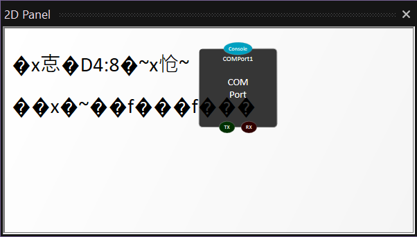

Posted: Mon Oct 27, 2025 10:29 am
by stefan.erni
Hi Martin
It look like a problem on my computers
That's not such a big problem, I always use an IRQ in my program. However, I shouldn't send any data before I activate it.
With IRQ:
Without IRQ:
I created a program for AppDevelopper FC11 to obtain the characters.
Terminal_FC11.fcpcd
(12.73 KiB) Downloaded 217 times
and improved the macro a little:
(15.99 KiB) Downloaded 206 times
