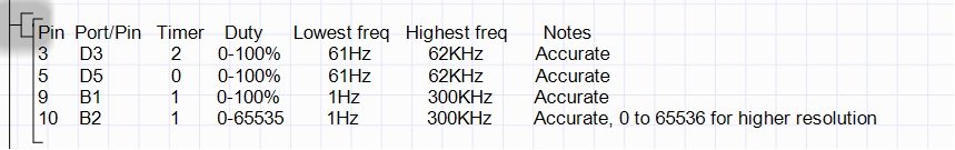

The PWM code within UNO is currently not accurate.
I have created a project to give you great accuracy for 4 PWM pins.
you can use that to generate required tones.
This is a screen shot of the notes I added within Main.
PWM notes.jpg (27.44 KiB) Viewed 3703 times

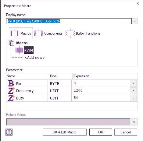

This is how you set pwm to a specified pin frequency and duty.
Uno Accurate PWM.png (27.67 KiB) Viewed 3703 times

When you use the PWM function the note will remain on.
you then can use a delay for the duration then to silence you can use a duty of 0 as that will just keep the pin low.
Alternatively after the duration of the first note, just add another PWM call function to set the PWM to the next frequency (note).
I could add another parameter for duration, but wanted to keep the call function a simple as possible.
