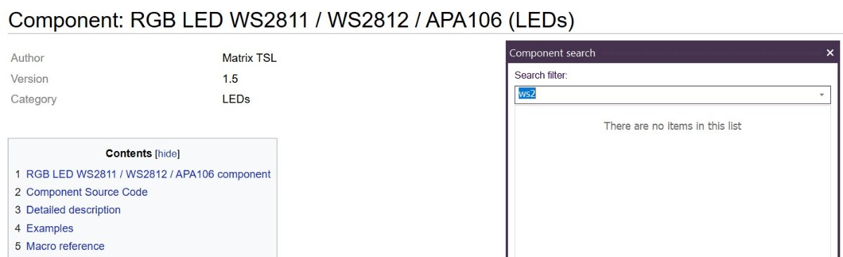

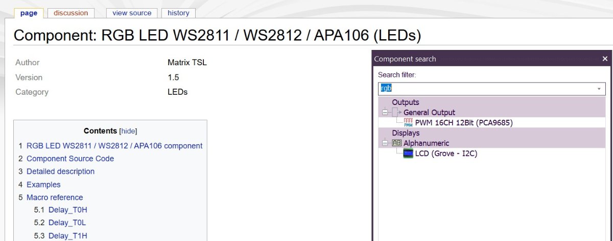

I am unable to locate the WS2812 RGB LED in the FC11 library. I have made two captures portraying the Matrix TSL Wiki vs. what I am searching:

Do you know why I do not see it there?

Re: WS2812 component missing in FC11?
Posted: Sun Nov 09, 2025 1:21 pm
by BenR
Hello Andreas,
Currently that's a 3d component and I imagine you have your component filter set to 2d only.
I might see if we can make a 2d version of the component to help avoid this issue. The people wanting the 3d version are probably in the minority.

You were correct - I had the components filter set by default to 2D, so that's why I was unable to see the component. Now I can see it, thank you for the tip!
