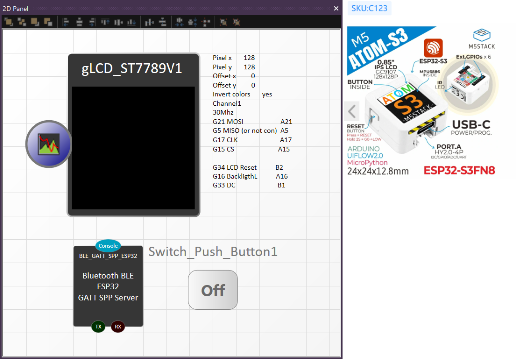

I'm using an M5 Stack Atom S3 with display.
This works very well with FC11.
Now I want to use BLE, but I get an error message as soon as I initialize the BLE component.
Atom_S3_Display_BLE.fcfx

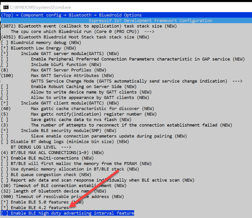

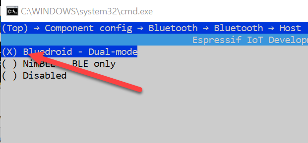

Another thing to note is in the menuconfig under Component Config -> Bluetooth. You must make sure Bluetooth is enabled, Host is Bluedroid and in Bluedroid options ensure that Enable BLE 4.2 features is checked.

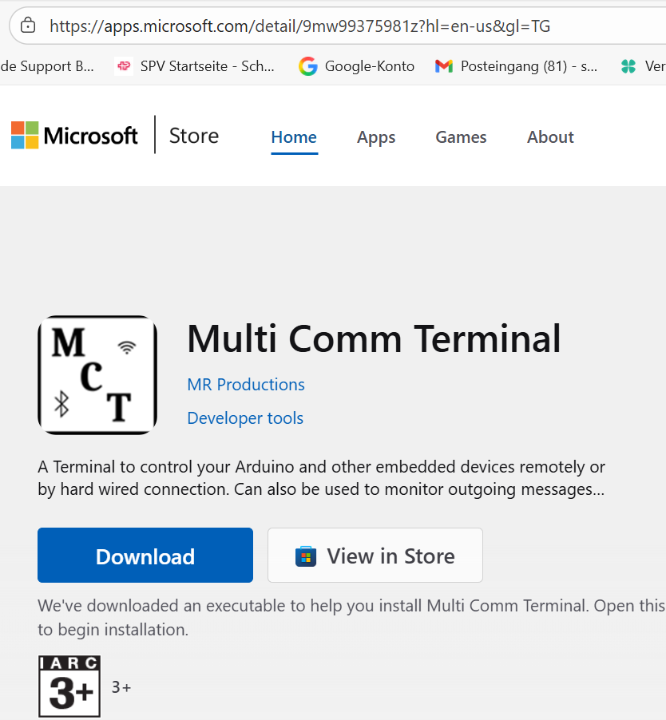

I installed a APP on the Computer but id did not found
I will test it some more.

I installed the Multi comm terminal on another computer,
and there I can receive the sent string from ESP32-S3 and BLE.

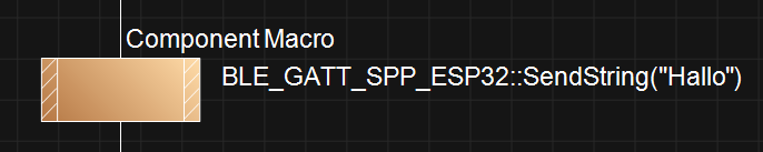

ESP32 send:
received App for Iphone:
received App for Androide:
