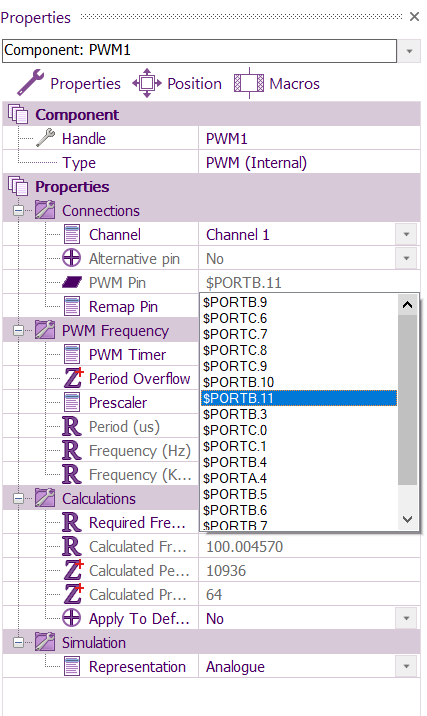

Hi, I am following up on this. I got things to work in my first application because I was using a single PWM channel. In my next iteration, I need to use 3 PWM channels. However, the dialog window to configure the PWM outputs on my 2D diagram has a limited list of pins and the pins linked to the PWM channels are not listed.
I am using a 44 pin dsPIC33EV256GM004 and it shows PWM1H on pin 14 (RB14), PWM2H on pin 10 (RB12) and PWM3H on pin 8 (RB10). Of these, only $PORTB.10 shows in the pull down menu. I don't see $PORTB.12 and $PORTB.14 I attached a screen shot of the configuration window as I see it on my computer. From the manual, it also says that the high speed PWM is not remappable.
Is it possible to access the pins I need or do I need to use a C-Code block?

Currently the definition for that family is only targetting the Output Compare / CCP type PWM. I'll investigate how easy it would be to also add support for the further 3 high speed PWM channels.
Re: dsPIC33 Sample ADC synchronous with PWM
Posted: Thu Feb 19, 2026 10:18 am
by BenR
On further investigation it looks like there might be one or two technical issues with allowing the 16-bit PIC high speed PWM.
For the 8-bit PICs the advanced PWM modules continue numbering from the CCP PWM but on the 16-bit PIC the numbers start again from 1 so the channel selection gets complicated but maybe isn't impossible.
There's also is a fair bit more configuration setup requiring unlocking resources. Again not impossible but gets trickier to manage in all cases e.g. if interrupts are firing etc.

Thank you for the detailed reply. This is all a bit over my head which is why I chose Flowcode in the first place.
In my first project (which is working), I used the PWM component and configured the PWM to $PORTB.10 and it is working fine.
My current PWM is configured at 40khz and I have a duty cycle range of 1500 counts (my master clock is 60MHZ).
Can I ignore the "high speed PWM" thing and just configure the pins with the PWM component? Will it work if I just choose pins that are available in the dialog box?
Posted: Fri Feb 20, 2026 10:48 am
by BenR
Yes the pwm channels and pins that are available now should all work fine without resorting to using any C code. It's just the high speed PWM peripheral that is currently unsupported which are the pins marked PWMxH, PWMxL in the device datasheet.
