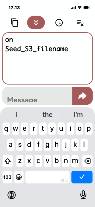

I have added the components to my program and am sending the filename to the iPhone via BLE.
It works very well.
Seed_S3_filename.fcfx
(14.47 KiB) Downloaded 339 times
printscreen Iphone:
