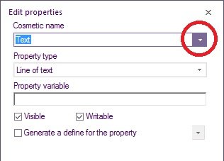

Tooltips for properties can be added by clicking in the drop down here inside the edit property window.
- Props.jpg (14.04 KiB) Viewed 5053 times

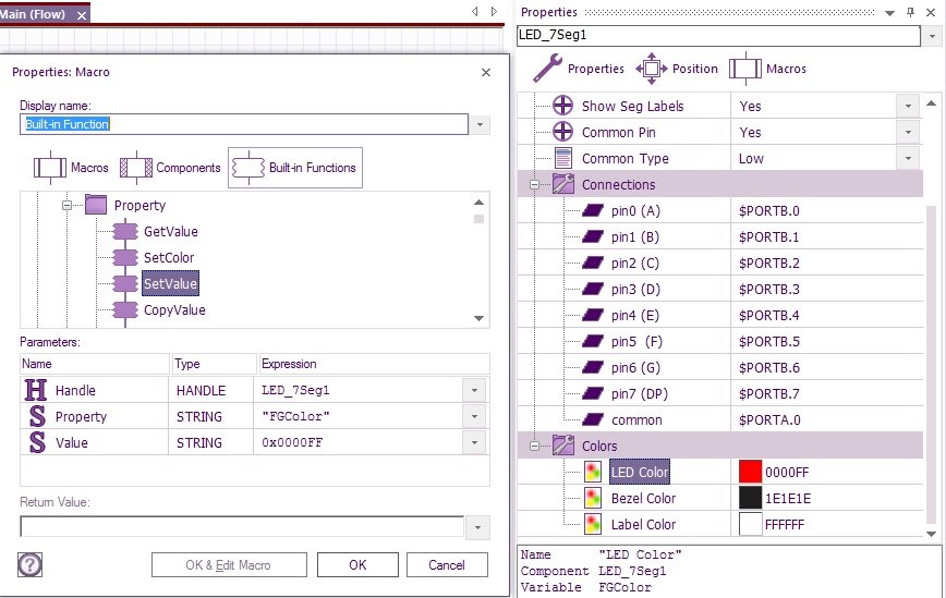

As for changing the value of a propety, this is done by clicking on the property you want to change to get the property variable at the bottom of the property window.
Then as Steve says use the Component.Property.SetValue function to set the RGB value of the property.
- SetValue.jpg (97.77 KiB) Viewed 5053 times
